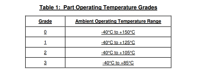

can help me to check which Ambient operating temperature range can awr1642 satisfy?
let me assume that the power of asr1642 consumption 2w. according to the Junction-to-free air is 22.3° , and the ambient temperature is 25°
so i can caculate the temperature of 1642 is 25 + 22.3*2 = 69.5°
but the datasheet says : 1642's Operating junction temperature range is -40 ~ 125;
so is this means the max ambein temperature of 1642 is 80.4° when the consumption is 2w?
