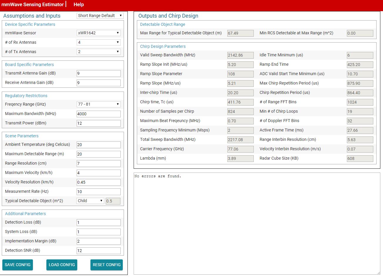

    The power calculator has a limited set of accepted conditions.  I modified your Sensing Estimator design, and modified the power input parameters.   The Sensing Estimator indicates that >=19 chirps per frame, are OK for these conditions.   Usually a smaller number of ADC samples per chirp are used, if there are velocity requirements.   In this case if your radar programming had 32 chirps per frame.  The power calculator would be providing a 64 chirp per frame power number.
    Note: the idle time limit may need to be extended per your end of chirp processing.   I have attached the revised Sensing estimator and power design, to get a better estimate, use a DC current probe on 5v current input, in your compiled example, toggle GPIO_1 at the beginning of radar programming, and after the data collection - frame processing, by measuring the software time, you can measure the frame radar, calculate power.

        "platform": "xWR1642",
        "num_rx": 4,
        "num_tx": 2,
        "tx_gain": 9,
        "rx_gain": 9,
        "frequency_range": "77 - 81",
        "maximum_bandwidth": 4000,
        "tx_power": 12,
        "ambient_temperature_degC": 20,
        "maximum_detectable_range": 20,
        "range_resolution": 7,
        "maximum_velocity_kmph": 4,
        "velocity_resolution_kmph": 0.45,
        "measurement_rate": 10,
        "typical_detected_object": "Child",
        "detection_loss": 1,
        "system_loss": 1,
        "implementation_margin": 2,
        "detection_SNR": 12,
        "maximum_radar_cube_size": 640,
        "maximum_RF_bandwidth": 5,
        "maximum_sampling_frequency": 6.25,
        "sensor_maximum_bandwidth": 4000,
        "maximum_allowed_bandwidth": 4000,
        "starting_frequency": 77,
        "maximum_velocity": 1.1111111111111112,
        "velocity_resolution": 0.125,
        "valid_sweep_bandwidth": 2142.8571428571427,
        "idle_time": 7,
        "adc_valid_start_time": 12.2,
        "excess_ramping_time": 1,
        "periodicity": 100,
        "ambient_temperature": 293.15,
        "noise_figure": 16,
        "num_virtual_rx": 8,
        "non_coherent_combining_loss": 3,
        "rcs_value": 0.5,
        "combined_factor_in_dB": -5,
        "combined_factor_linear": 0.31622776601683794,
        "inter_chirp_time": 20.2,
        "aux_comp_coeff_a": 78071428571.42856,
        "aux_comp_coeff_b": -32146814.285714287,
        "chirp_time": 411.7615736505033,
        "ramp_slope_init": 5.2041212196162,
        "ramp_slope_parameter": 108,
        "ramp_slope": 5.214214324951172,
        "aux_comp_T1": 1,
        "maximum_beat_frequency": 0.6952285766601562,
        "sampling_frequency": 2,
        "number_of_samples_per_chirp": 824,
        "total_sweep_bandwidth": 2217.0839309692383,
        "idle_time_minimum": 6,
        "ramp_end_time": 425.2,
        "carrier_frequency": 77.06361438372019,
        "aux_comp_T2": 9.7,
        "adc_valid_start_time_2": 10.7,
        "lambda": 3.892887744743198,
        "max_chirp_repetition_period": 875.9,
        "chirp_repetition_period": 864.4,
        "num_range_fft_bins": 1024,
        "min_num_of_chirp_loops": 19,
        "max_range_for_typical_detectable_object": 67.49001259481163,
        "min_rcs_detectable_at_max_range": 0.0038559549405853184,
        "num_doppler_fft_bins": 32,
        "active_frame_time": 27.6608,
        "range_inter_bin_resolution": 5.6328125,
        "velocity_inter_bin_resolution": 0.07421875,
        "radar_cube_size": 608

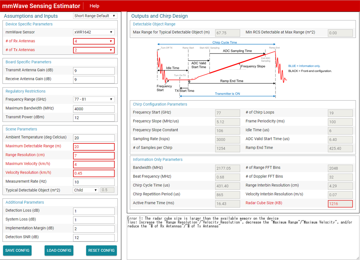

    I tried to load your config(design_51718.json) to Sensing Estimator, but it generates an error.
    Is this correct file?
    Error 1: The radar cube size is larger than the available memory on the device
    Tips: Increase the "Range Resolution"/"Velocity Resolution", decrease the "Maximum Range"/"Maximum Velocity", and/or reduce the "# of Rx Antennas"/"# of Tx Antennas"

  • Hello
    Using the Sensing Estimator 1.01, the  design_51718.json, does not generate an error for my software.  This used a 1642 example.  If you are trying to fit these constraints into a IWR1443, select this at the top, and increase the max velocity, decrease the velocity resolution to lower the number of ADC samples per chirp.
    Reducing the number of Tx or Rx antennas - lowers the Radar Cube size.
    Lowering the number of ADC samples per chirp - lowers the Radar cube size.
    The power calculator has a minimum of 64 chirps per frame, you would lower the meausrement power, the boot power would be the same.,   This is why I suggested that eventually you have to measure the example on the EVM.
    Example - if you selected xWR1443 as the mmwave sensor, then change max velocity to 10 km/h, and velocity resolution to 1.5 km/h  - we fir within the xWR1443 radar cube size.
    Joe Quintal

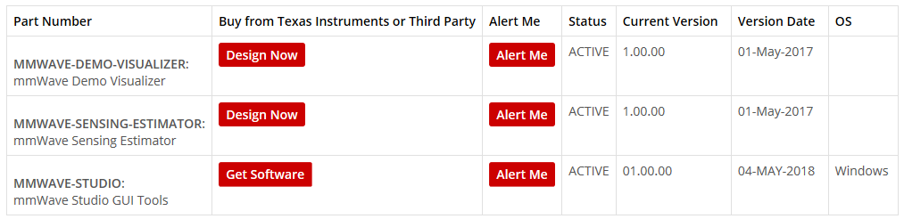

  • Hi Joe,
    My tools generates an error like this;
    Where can I get version 1.01? The latest one is 1.00.00 and I used this version.
    Thanks and regards,
    KoT
    If you use the "i" indicator the web version is currently 1.2, " dev.ti.com/.../ "

    I have entered the values starting with the top left, and editing the values as shown.
    Please try this with Sensing estimator 1.01, or 1.02.
