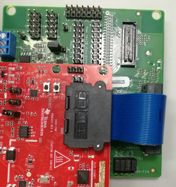

I connected TSW1400EVM to MMWAVE DEVPACK, which is connected to MMWAVE AWR1642BOOST and tried to capture data with HSDC pro. After finishing the settings, I followed the instruction
However, I'm getting the "Clock from ADC EVM not received by FPGA board" message from the HSDC Pro software.
I know the LED3 on TSW1400 should be on if a correct clock signal is received from mmWave-devpack. However, it is not on.
 mmwave-devpack's jumper settings as shown below.
Can anyone tell me anything wrong?
