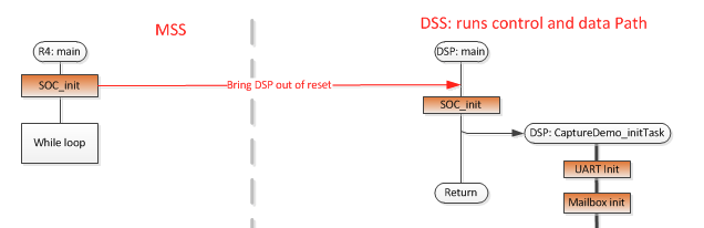

Do I need to write separate apps for the MSS and DSS of the AWR1642?
Based on:
And because of:
2. DSS only mode
When working in this mode, the demo runs on DSS only. However, executable image of MSS is additionally required to be loaded and run on R4 for the purpose of performing SOC initialization
It looks to me like I need at least a minimalist MSS app, am I right?
  • Former Member
    0 Former Member
    Hello Juan,
    This is correct. For an example of a lab that runs mainly on DSS with minimalist MSS please see the Short Range Radar lab:
