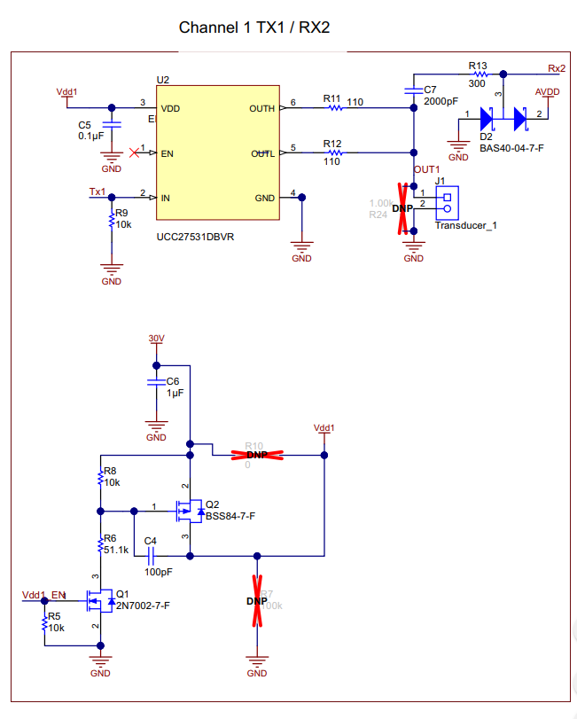

i want to use the TDC1011 IC with DRV2700 to drive a transducer with 40kHz.
I can use an opamp to take the TX(TDC1011) and make it differential to the inputs of DRV2700.
The DRV2700 will drive the transducer up to 100V or +-100V.
How do i connect the RX wire from TDC1011? Do i need a level shifter?
Or disbale DRV2700 once the Burst is send out and Enable the receive side ?
