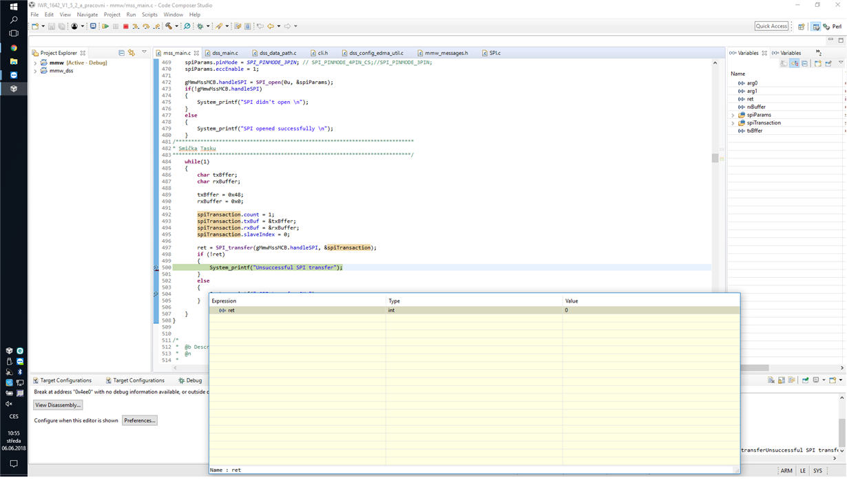

I have a small problem. I have IWR1642BOOST kit and I would like to use its SPI unit for sending data to external board. The SPI is realized on mss. My program is modified demo from SDK:  mmwave_sdk_01_00_00_05 where my interframe function compute the range/angle matrix for 16 doppler chirps. This matrix will be send after inter frame by SPI. I read and modified SPI example for IWR1442. Thi initialization is done but when I call transmition the transfer is not done.
Here is my code:

void Mmw_SPIDataLoggingTask(UArg arg0, UArg arg1)
SPI_Params spiParams;
SPI_Transaction spiTransaction;
int32_t ret;
System_printf("Start SPI task\n");
* SPI nastaveni
SPI_Params_init(&spiParams);
spiParams.mode = SPI_MASTER;
spiParams.transferCallbackFxn = NULL;
spiParams.transferMode = SPI_MODE_BLOCKING;
spiParams.transferTimeout = SPI_WAIT_FOREVER;
spiParams.u.masterParams.bitRate = 1000000;
spiParams.u.masterParams.numSlaves = 1;
spiParams.u.masterParams.slaveProf[0].chipSelect = 0;
spiParams.u.masterParams.slaveProf[0].ramBufLen = MIBSPI_RAM_MAX_ELEM;
//spiParams.u.masterParams.slaveProf[0].dmaCfg.txDmaChanNum = 1U;
//spiParams.u.masterParams.slaveProf[0].dmaCfg.rxDmaChanNum = 0U;
spiParams.frameFormat = SPI_POL0_PHA0;
spiParams.shiftFormat = SPI_MSB_FIRST;
spiParams.dmaEnable = 0;
//spiParams.dmaHandle = dmaHandle;
spiParams.pinMode = SPI_PINMODE_3PIN; // SPI_PINMODE_4PIN_CS;//SPI_PINMODE_3PIN;
spiParams.eccEnable = 1;
gMmwMssMCB.handleSPI = SPI_open(0u, &spiParams);
if(!gMmwMssMCB.handleSPI)
System_printf("SPI didn't open \n");
else
System_printf("SPI opened successfully \n");
* Smička Tasku
while(1)
char txBffer;
char rxBuffer;
txBffer = 0x48;
rxBuffer = 0x0;
spiTransaction.count = 1;
spiTransaction.txBuf = &txBffer;
spiTransaction.rxBuf = &rxBuffer;
spiTransaction.slaveIndex = 0;
ret = SPI_transfer(gMmwMssMCB.handleSPI, &spiTransaction);
if (!ret)
System_printf("Unsuccessful SPI transfer");
else
System_printf(" SPI transfer OK ");
    int32_t ret;
     * SPI nastaveni
    else
     * Smi�ka Tasku
    while(1)
        char txBffer;
        char rxBuffer;
        txBffer = 0x48;
        rxBuffer = 0x0;
        if (!ret)
        else
