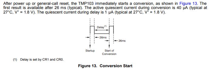

About mentioning of 22 pages of datasheet,
1.After power up, is the power consumption for first 26ms 40μA?
 (typical at 27°C, V+ = 1.8 V)
2.How much is the power consumption approximately during conversion at V+=3V?
 (typical at 27°C, V+ = 3V)
itabi
  • Hi Itabi-san,
    1. After power up, is the power consumption for first 26ms 40μA? (typical at 27°C, V+ = 1.8 V)
      • Yes
    2. How much is the power consumption approximately during conversion at V+=3V? (typical at 27°C, V+ = 3V)
      • I reviewed the characterization data; unfortunately, we do not have the data for 3.3V. However, the data shows at 3.6V is ~47µA.
    Hope this helps. Let me know if you have further questions.
    Aaron
