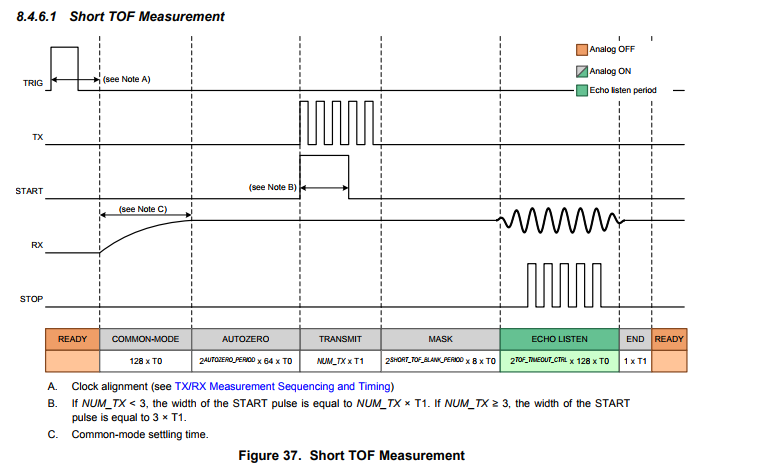

I want to make Short TOF Measurement with a TDC1000-GASEVM. In Standard TOF Mode it is working as expected but as soon as I switch to Short TOF I can't get a signal to the transducer connected to TX1 on the booster board. Measuring TX1 on the connector between GASEVM and Booster Board i can see the 3 Pulses without amplification. Am I doing something wrong?
    You are probably not setting the HV boost period for long enough. With Short TOF mode there is a significant time between the trigger signal and when the TX pulses are output. You will need to increase the HV boost period to account for this extra time:
