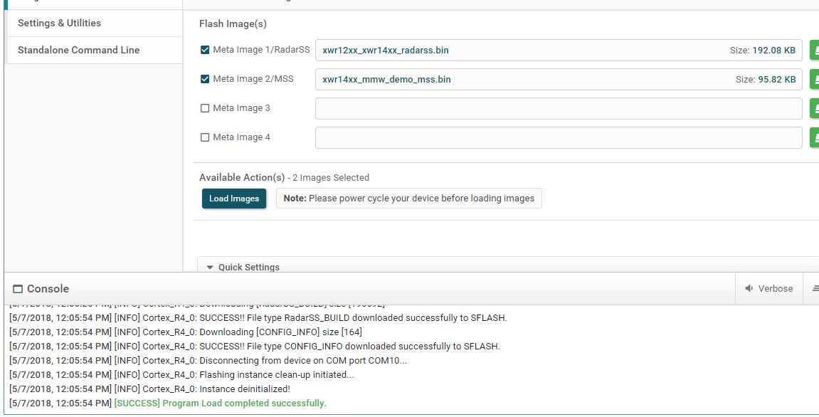

I have a custom board utilizing the AWR1443 which is designed very closely to the AWR1443BOOST in a different form factor.  I would like to test the hardware (primarily new antenna design) utilizing the mmWave Demo Visualizer.  I have successfully loaded the image files to the device:

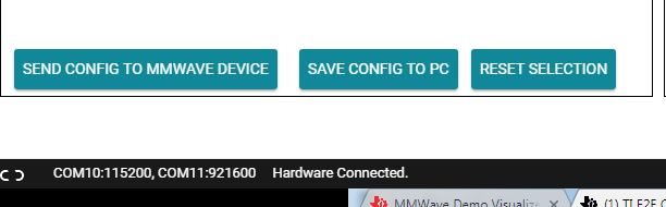

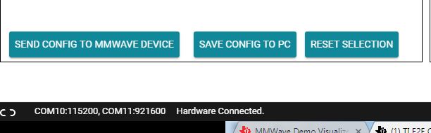

Upon opening the Visualizer, I configure the serial port correctly, set the Platform to xWR14xx, the SDK version to 1.1 and leave the rest as is.  I successfully get the Hardware Connected response:

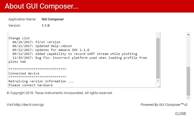

When I press the Send Config To MMWave Device, I get no response in the Console Messages window.  When I check the Help/About window there is no device specified:

  • Hi Brendan,
    This behavior seems consistent with a board that is still in flashing mode. Can you confirm that you have removed the SOP2 jumper after flashing?

    Upon initial plugin to the PC, I need to load the XDS110 bootloader and firmware binary files onto the TM4C1294 chip utilizing the XDSDFU program.  Once successful, I use UniFlash to format the SFLASH and then successfully program the image files (both RadarSS and MSS found in the mmwave_sdk_01_01_00_02 folder).  I compared the console output of the AWR1443BOOST with my custom board during this process and they were matched line for line.
