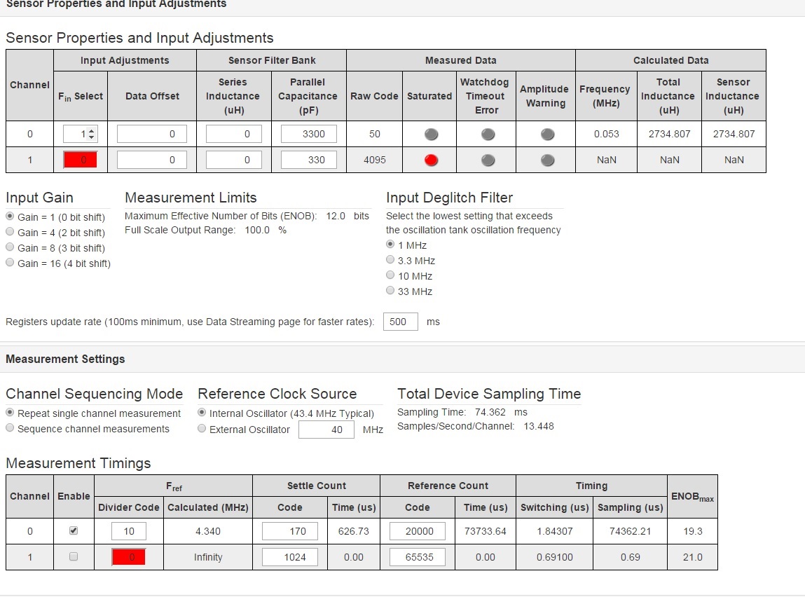

Hello Everyone,
I have and inductor with L = 2,2mH and the capacitor to create the oscilation frequency is C = 3,3nF. The oscilation frequency is about 58000 KHz. I´m using the LDC1312 to get the presence of the target. When I place the target around the inductor, instead of, the frequency increase ie is decreasing. Ii this an abnormal behavior in lower frequencies? The configuration in Sensing Solutions EVM GUI is:

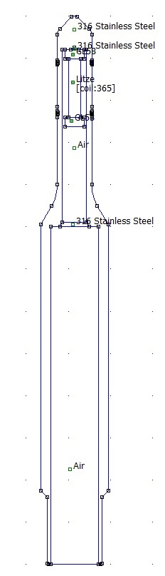

    I need a lower sensor frequency because in my application I have a coil (ferrite + wire) and this coil is placed in a housing built of Stainless steel. The magnetic field generated by the coil should pass this "fence" and detect the target. The sensor Works like a steel face inductive sensor. A drawing showing my application you can see in the Picture below:
    Look, the sensor frequency should be lower as possible to detect the target.

  • Hi Filipe,
    I'm glad to see you are using FEMM to simulate your coil. I would suggest adding a target to your simulation to determine whether or not your coil's inductance will change within the steel housing. If you have difficulty with this you can send your FEMM files to me via a private message.
