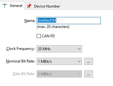

4) CAN Analyzer
a) Clock Frequency: 20 MHz
b) Bit Rate: 1 MBit/s

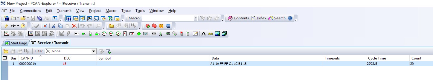

c) CAN messages is received on CAN analyzer

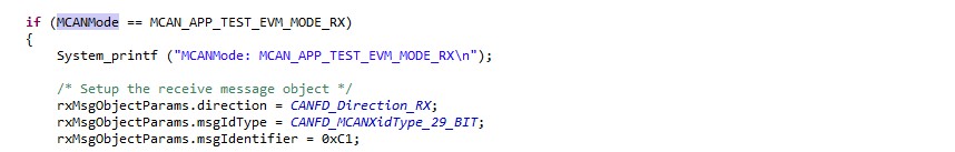

b) compiled code by hardcoding "testSelection=4" and "gDisplayStats=1" for transmitting and receiving CAN.
c) Connect Target Cortex_R4
d) Load Program xwr16xx_can_mss.xer4f, just compiled on b)
e) Run Target Cortex_R4
We didn't see any activity on the PCAN USB.
For 3) b), could you advise us what do you modify and create xwr16xx_canfd_mss_Tx_mode.xer4f ?
