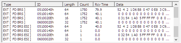

RTOS/AWR1642: MCAN will crash when Data Bit Rate=8MHz.
Part Number: AWR1642
Tool/software: TI-RTOS

It can run at the beginning. But it will error after a while.
This is the ErrorCode in CCSDebug.

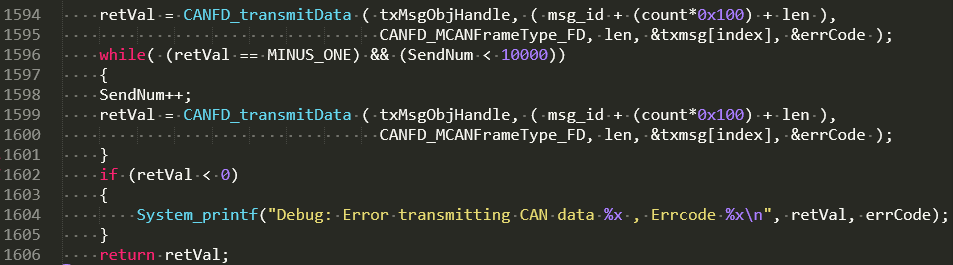

This is my code for Transmit.
