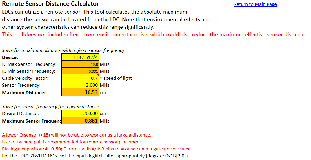

    Also note that driving an LC tank with a long connection is typically not recommended. If the length of the wire gets long (in comparison to the sensor wavelength) then you could run into transmission line effects like phase shifts that can corrupt the switching behavior of the device. If your sensor frequency is 3MHz then we don't recommend a transmission length >0.35m. If you have to drive the sensor remotely at 2m distance then you should consider lowering your sensor frequency <1MHz to avoid this effects.

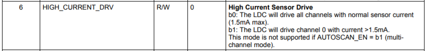

    Just use caution when lowering the sensor frequency, because if the inductor is fixed then increasing the sensor capacitor will lower the frequency but also lower the sensor RP and Q factor. If the RP gets too low then the sensor amplitude will be low as a result or the device may not be able to drive the sensor. If this is a single channel application then you can use Channel 0 and High Current Drive mode to increase the the capabilities of the device.
