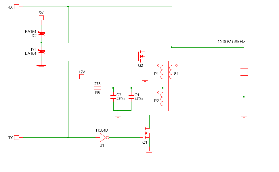

I need to drive a transducer with 1200V for its optimum performance. Would I be able to configure the TDC1011 TX signal as in the circuit below to drive a centre tap transformer and feedback the TDC1011 RX signal?
