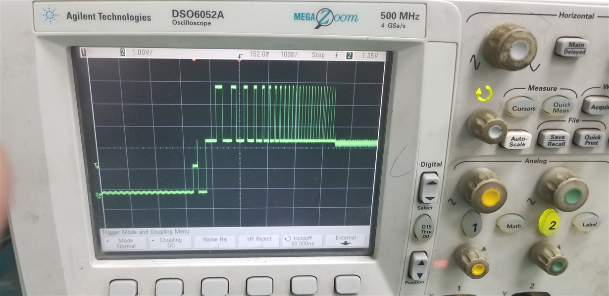

  • this is output waveform in my system

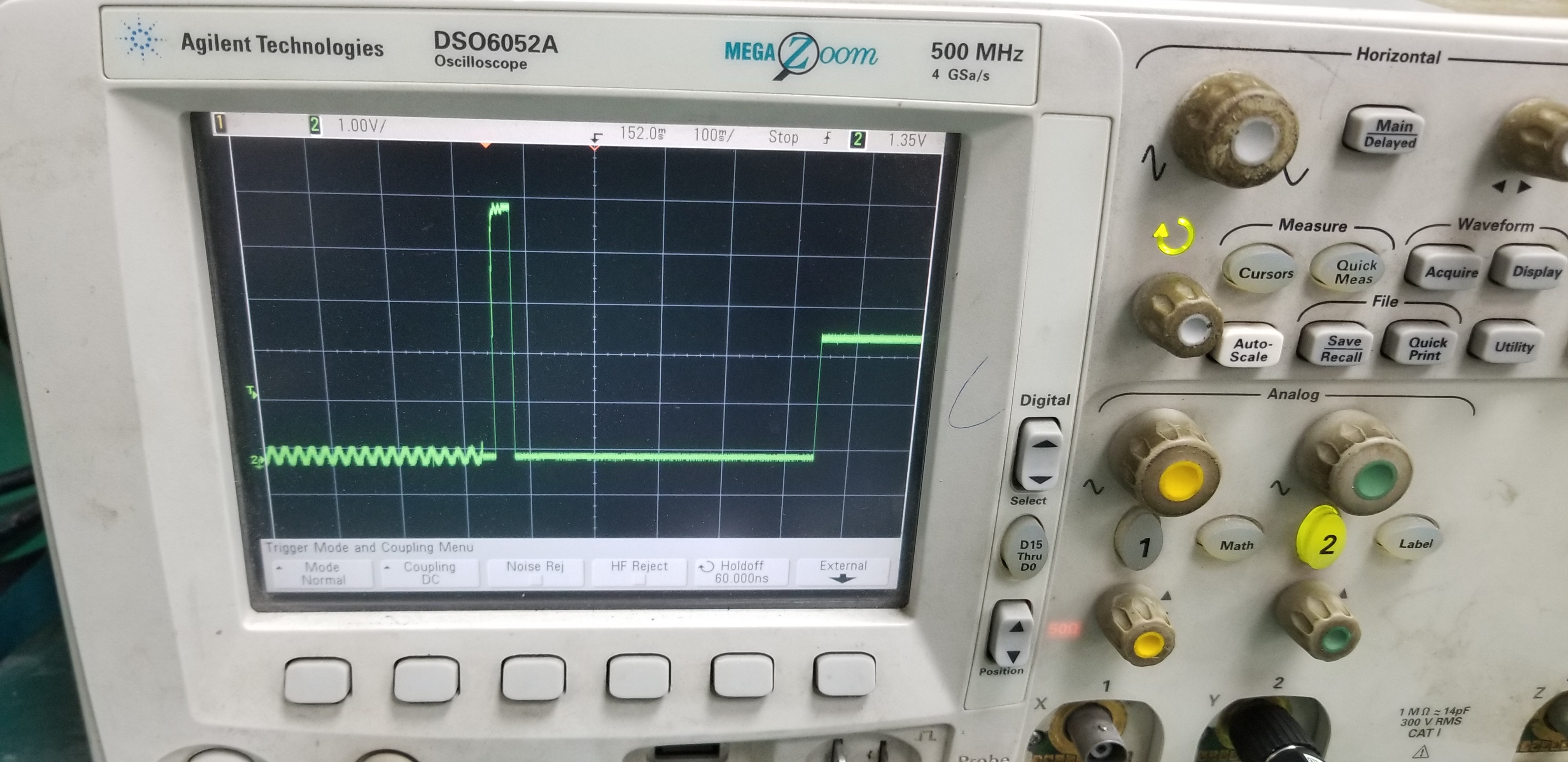

    this is Icomp2 waveform in a DEMAG cycle

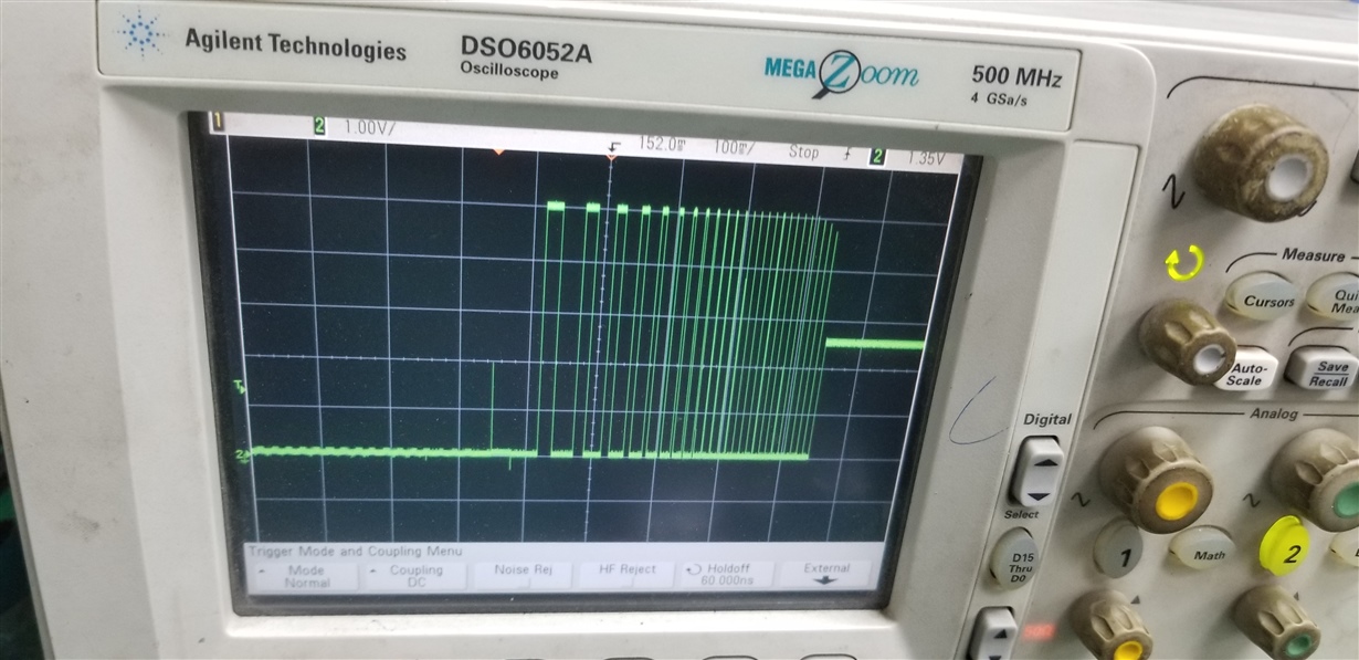

    this is Icomp1 waveform in a DEMAG cycle
    these waveforms are a little different from the SPEC, and I found that in a DEMAG cycle ER pin was still keeping high-level .
    (test condition is Rshunt= 1k)
    when Rshunt <100Ω,it will skip the DEMAG cycle, it makes me puzzled.

    I am not sure why you are not seeing the Demag cycle during the lower Rshunt values as the Rshunt does not change if the Demag cycle is applied.  You may see the ICOMP pins should hit the rails during the demag function in both conditions.  The output will be based on the Rshunt and the current running through. During the demag the coil must get saturated in order to demagnetize.
    I also simulated the core you described.  I am not sure if this is the cause of the drift as I still think there is an issue with the demag of the core as well which could be related to the number of turns and being able to saturate the core to force a demag.  The core I simulated gave me an inductance of ~40mH.  From the datasheet for the stability we recommend larger than 300mH but 100mH should work.  He have more on this in the document link below.  I have also attached my simulation file which was ran using FEMM a free tool available online.

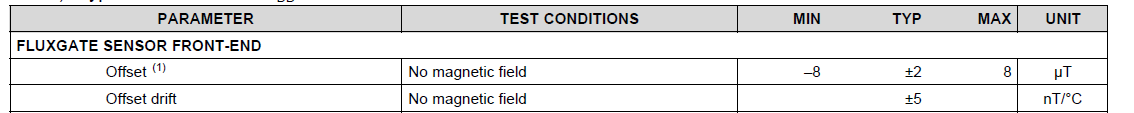

  • if  offset is 8uT , N=500 ,primary coil magnetic Gain=4000uT/A(from my design )  ,  So   compensation coil Gain=4000uT/ 2mA .
    when there is no magnetic field,  offset 8uT will generate 4uA error current ,  so when Rshunt =1k,  the differential voltage is 4mv, the output voltage is 2.5V±16mV
    Is my uderstanding right?
  • User4308845,
    Please excuse my delayed response. The magnetic gain is dependent on the position of the sensor relative to your magnetic core and the air gap size. From my simulations based on the details you provided from the core I simulated the gain between 800 uT/A - 900 uT/A. So if we have an error only coming for the sensor the calculation would be as follows. Please note these are assuming the core is not magnetize. Also I have never attempted a core that has lower inductance than the recommended 300mH.
    8µT / 800µT/A = 10mA error on Primary (Magnetic Gain of 800uT/A)
    10mA/500 = 20µA error current on compensation coil (N= 500)
    20µ*1KΩ = 20mV Voltage input to Diff Amplifier (Rshunt = 1KΩ)
    20mA *4 = 80mV Voltage after Diff amplifier.
