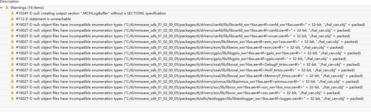

First:When I use CCS to program CANFD, the compiler will always have the following warning. How can I get rid of this warning? What is the source of this warning?

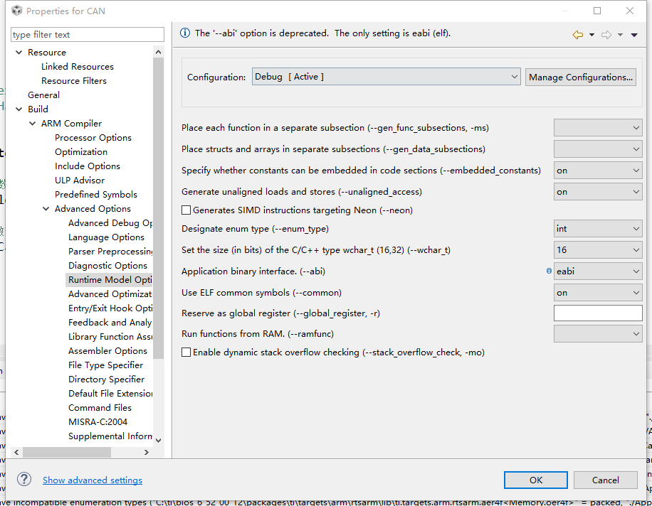

    How did you create the CANFD CCS project?
    Thank you
    Cesar
  • #1) For SDK 1.2 or 2.0, you must compile the MSS code with "int" enums to match the DSS' enums.  Two changes are needed in the CCS Project Properties:
    Build->ARM Compiler->Advanced Options->Runtime Model, set --enum_type to "int".
    Build->XDCtools->Advanced Options, on --compileOptions, set the field to "--enum_type=int ".
    Then do a clean build.

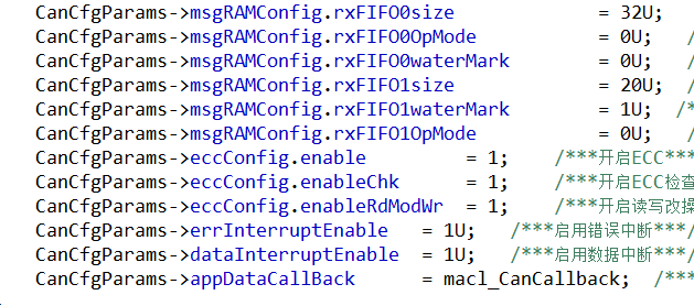

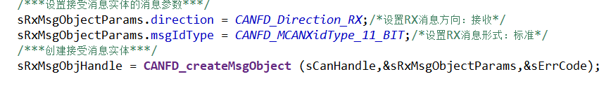

    For the last ,i can show  the configuration about my CANFD RX Message Object:
    This is my configuration,and i looked at the unit test ,but is not help me.Can you look the configure and  give me some advice?

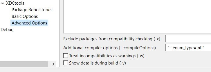

  • For the first, i am done,but the warning is still staly.what is wrong?
    thanks
    The warning is still,When i change the two CCS Project Properties:
    What's wrong?

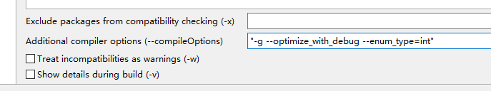

  • It seems that BIOS is still being built with packed enumerations.  Set the XDCtools --compileOptions field to this, exactly:
    Notice the space between int and ".  Why do you need to compile the BIOS with debug mode?  Fix the issue first, then if you do need -g you add it later.
  • hi,
    when i set the field as your advice,but it still has these wrining ?
    which way to compile the BIOS ?
  • Did you do a clean build so that BIOS is rebuilt?
