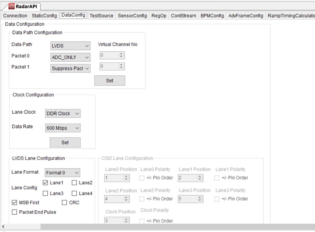

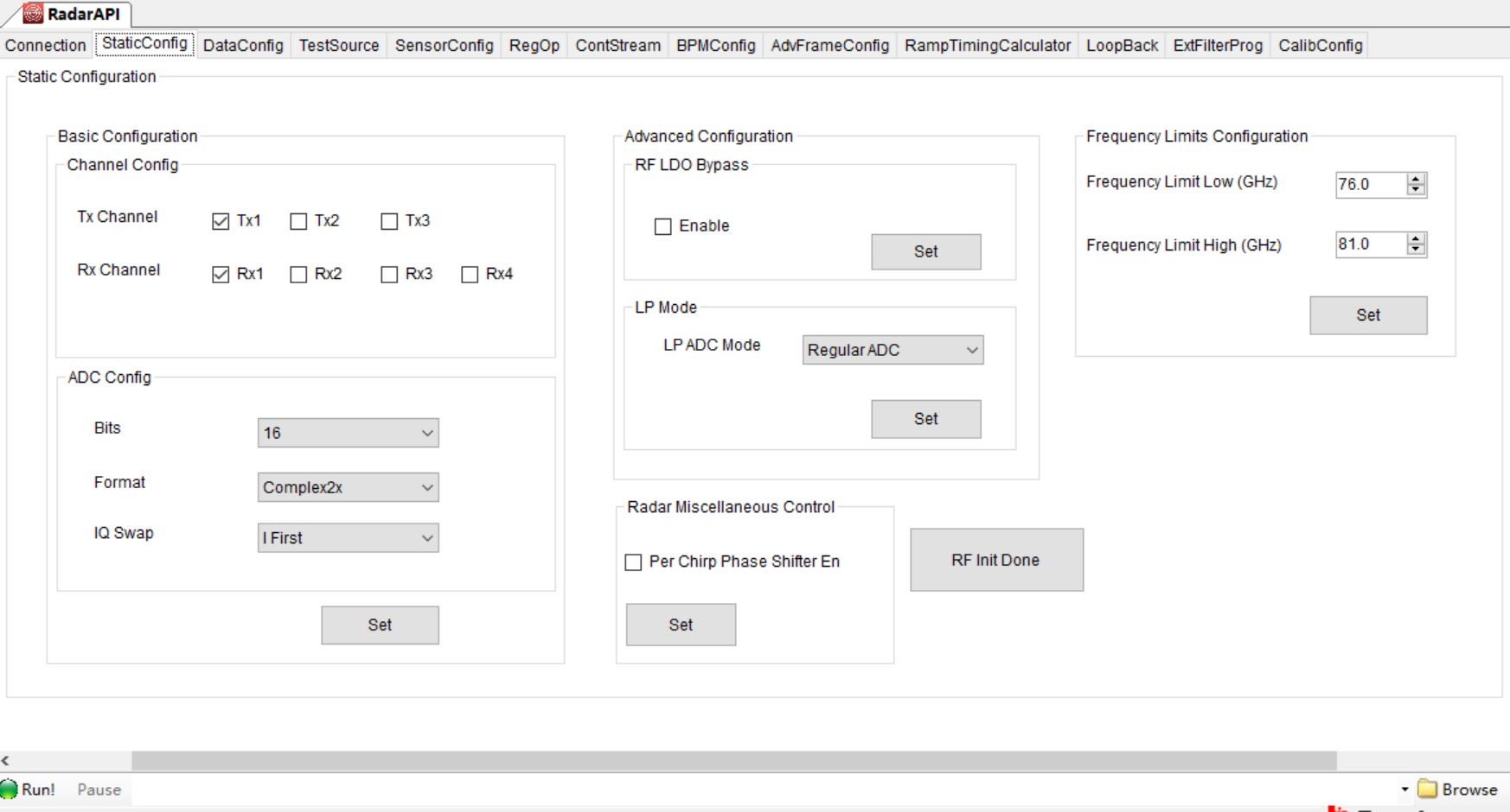

hi, can anyone can help me ? my capture data is wrong, I do not know why. My voltage and electricity is 5V/5A

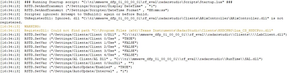

    I think upgrading to the new DFP version will help.
    I have faced similar problems earlier and upgrafing to Radar studio version 1.9.x (comes with DFP version 1.0.x) helped.

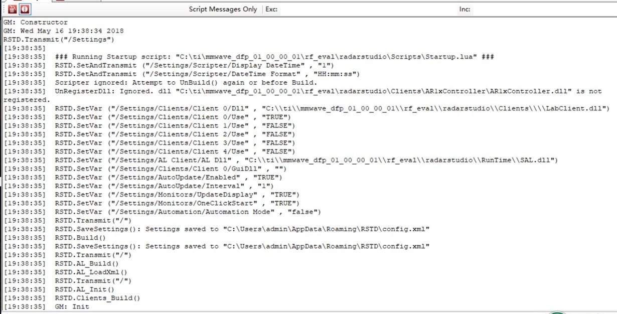

  • hi, thank you for your answer, but when I use the  DFP version 1.0.x. I will get a warning below.  And my data is still wrong

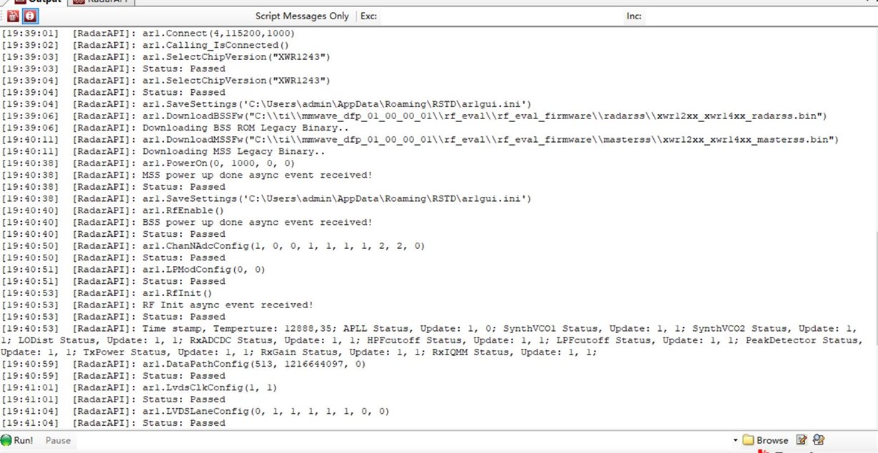

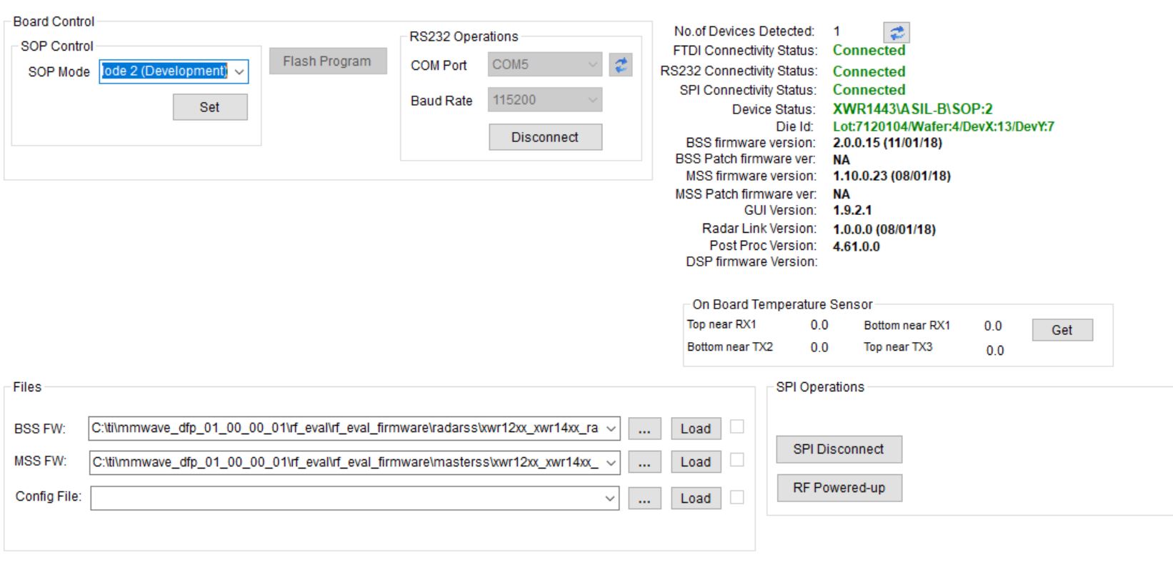

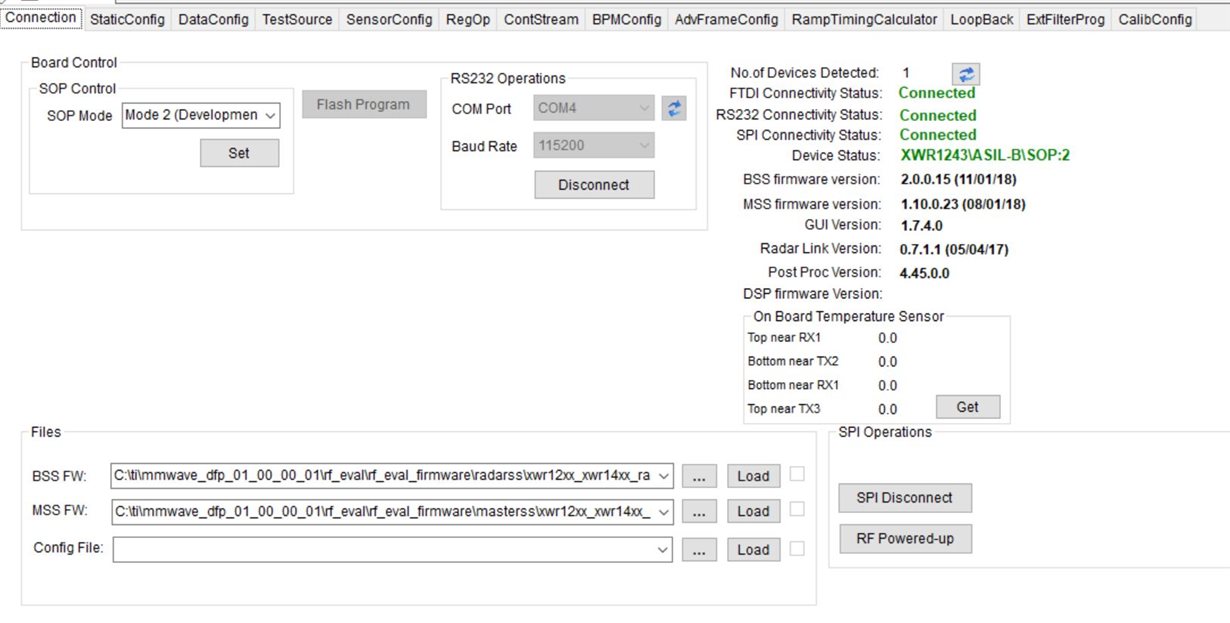

    I also get this warning. I believe this is not an issue to get proper data.
    I notice that your question says AWR1243, but the Radar Studio (1.9) Connection tab screenshot says the device is AWR1443.
    I think there is some mismatch of the hw/fw being used.
    Hope it helps

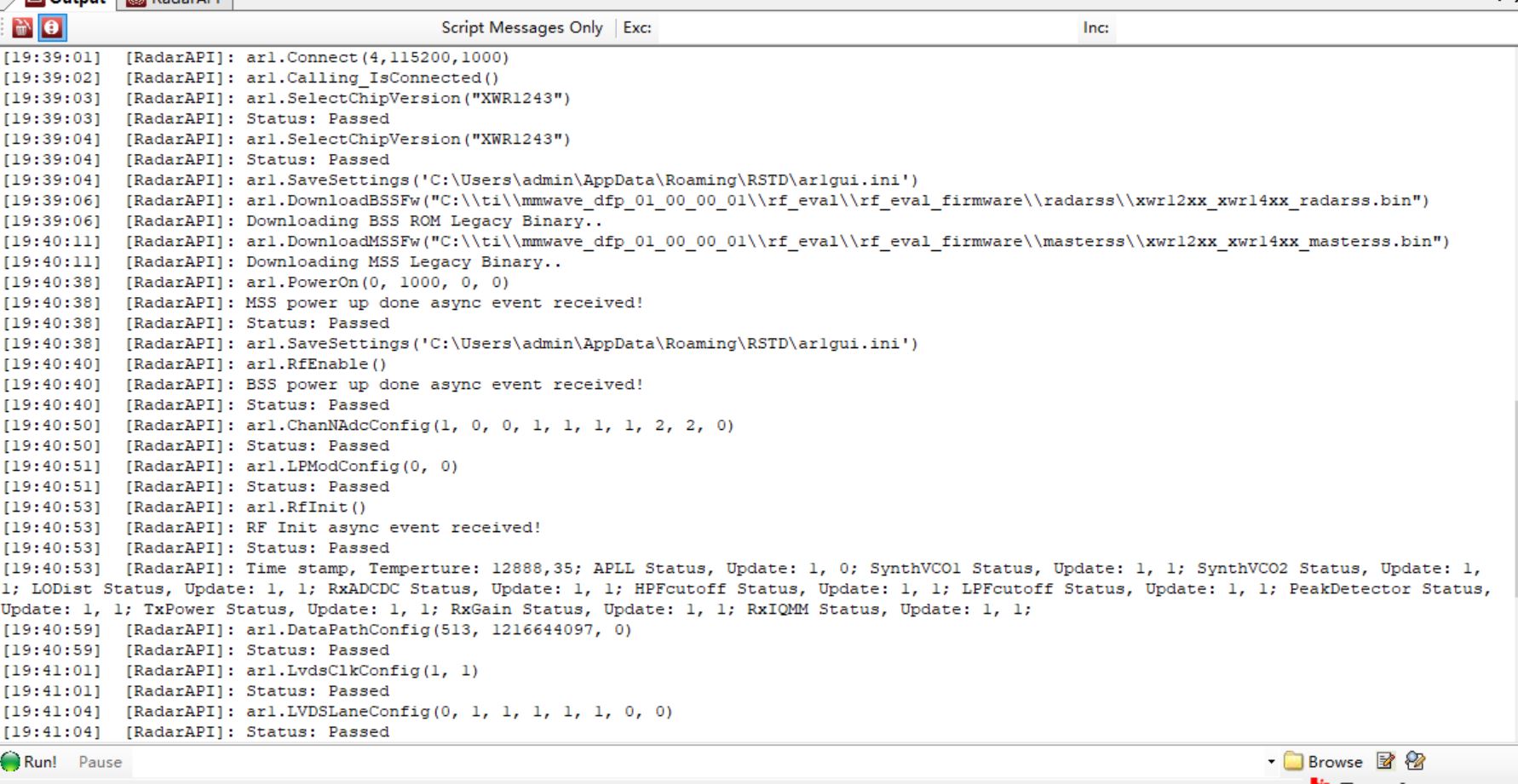

  • I have both AWR1243 and AWR1443, so I did them both. both of them have the same problem
  • there is no error,but in log file, Error in Data collection. Please try again. Make sure that there is sufficient time (2 secs) between arming and triggering the frame. Also, make sure that the LVDS is active on the AR device and that the TSW1400 is active with the correct firmware.,0,     it is always there
  • I have show my result, can you help me to solve this problem? thank you very much

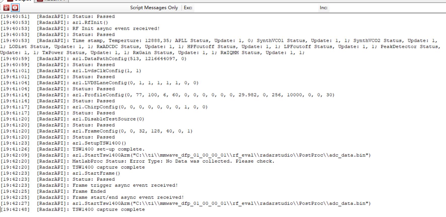

    I re-checked my Radar studio Log and output messages. It is exactly similar to yours. 2 observations:
    One,
    I get the same error in my log output also. But my data is fine. I check it both in Mtlab and Post proc tab
    How are you verifying that your data in wrong
    Two,
    If I use the older MSS firmware (from DFp 0.7.x), then this error in log file doesnt come.
    Hope this helps

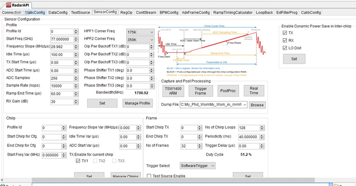

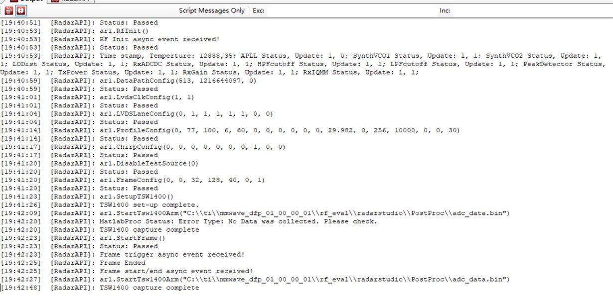

  • hi, thank you for your answer. Here are some reasons why I say the data is wrong:
    (1)When  I set the radar parameters to get a high range resolution(3.5G bandwindth) and a small  velocity resolution(0.04m/s). but when I do some cycle body movement, after 2-D fft, there is no range or velocity change. So from this I think the data I get is wrong.
    In fact , when I use the radar stduio, I have set all parameters passed. there is also no error in radar stduio output. but I can not get the result I want
    (2)When I use the older MSS firmware (from DFp 0.7.x), then this error in log file is still there.
    How are you processing the data? Are you using the Radar Studio post processing tool or a custom post processing?
    Can you try to stand at a fixed distance (i.e. 3m) and see if the processed data shows that you are at 3m?
  • hello , I have used the DCA 1000 EVM to capture the raw data , the data captured by DCA 1000 EVM  is right.
    That is good. Are you still having issues with the TSW1400? If so, are you processing the data using the Radar Studio post processing tool or a custom post processing?
    Adrian
  • no, My problem has been solved. Thank you for your help .
