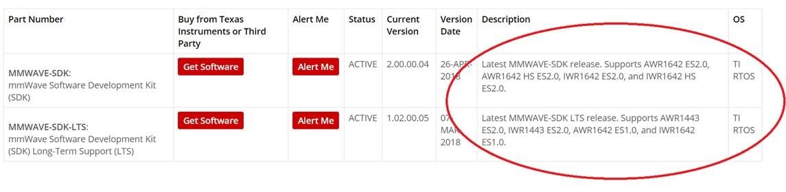

Hi TI team,
Why AWR1642 ES1.0 and ES2.0's SDK different support package?
What is the difference between MMWAVE-SDK and MMWAVE-SDK-LTS?
Best Regards.
Hacker Hsu
  • There are differences in the silicon between ES2.0 and ES1.0 which require updated SW support. This is the reason why there are two different SDKs
    Long Term Support is an SDK version that will be supported for a longer period of time. For the SDK it is 1 year
