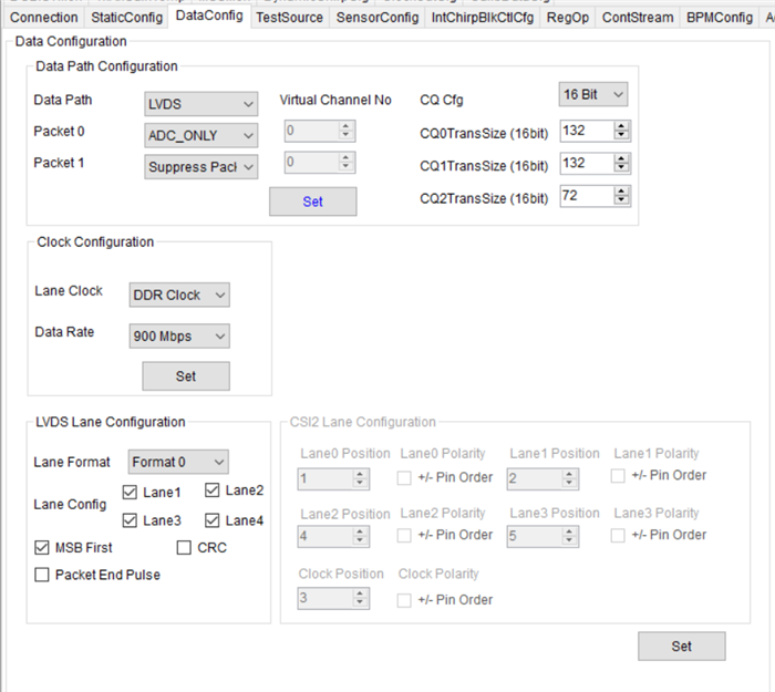

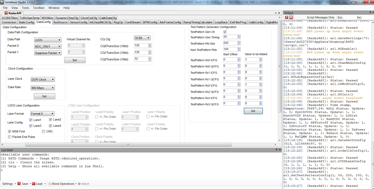

I am trying to use Test pattern generator through AWR1243+TSW1400 + Radar Studio.
When I set the LVDS data rate to 900Mbps, and the test source is enabled, There is a CRC error when I click the set button (of Test Source)
This CRC error doesn't come when I have the LVDS data rate to 600Mbps.
When I set the data rate to 900Mbps and send actual capture data, the data is received successfully captured by TSW1400.
Any suggestion on this area would help.
