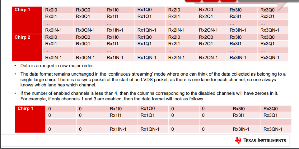

This is part of the AWR1642 sampling data with one TX antenna and two RX antenna and is saved as a binary file. I don't know the format of the data.It differs from the data format given in the second picture.
