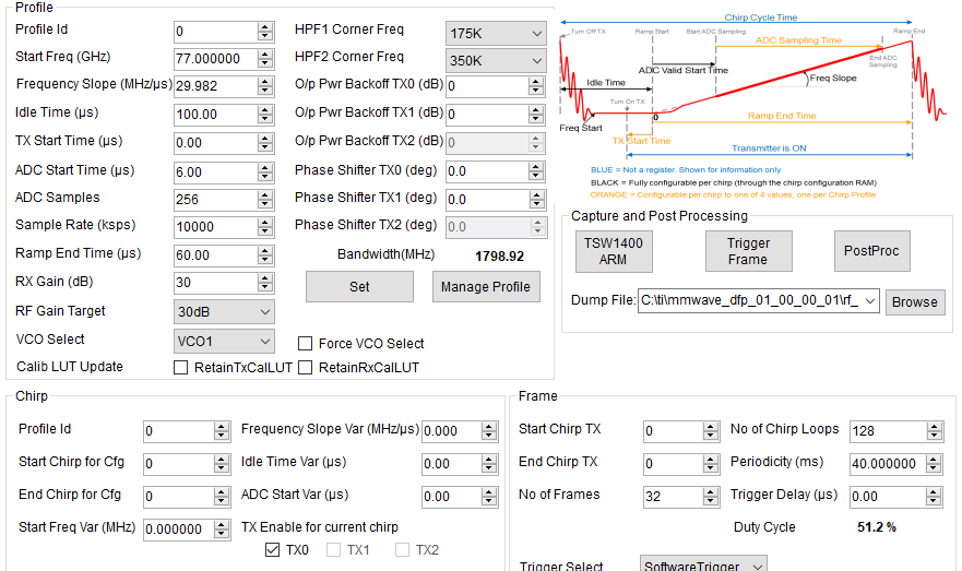

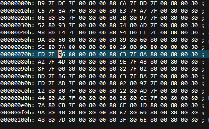

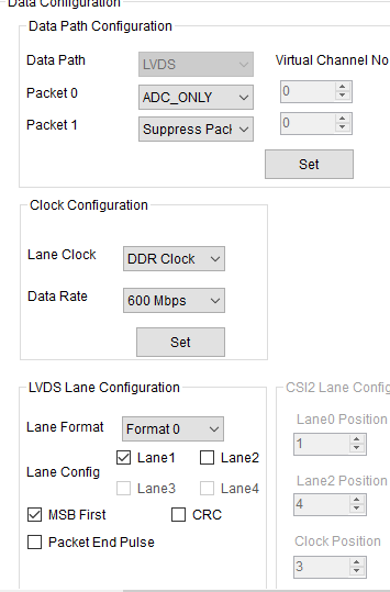

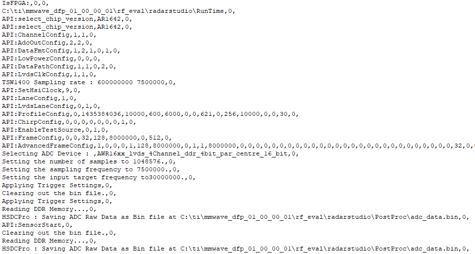

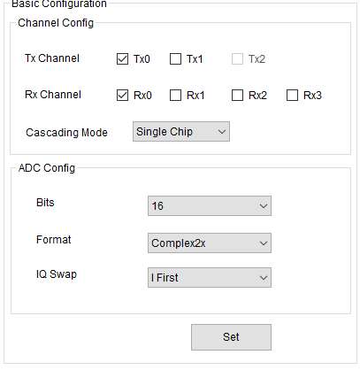

The first picture is the binary data file collected by AWR1642, and the second picture is the log file. The last three pictures are configuration of staticconfig;dataconfig and sensorconfig. I would like to ask why there is a fixed 0X00 0X80 in my binary data.
