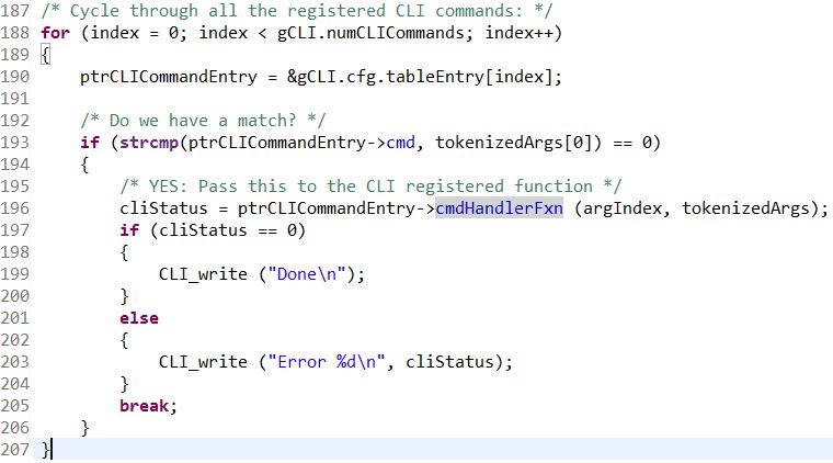

My goal is to write custom configuration commands for the CLI - like sensor start/ stop for example.
Starting out it needs no functionality. When entered the command should simply be recognized with the "Done" echo.
Currently I understand that the cli.c in C:\ti\mmwave_sdk_01_02_00_05\packages\ti\demo\xwr16xx\mmw\mss are added to a table.
How is the input further processed?
The cli.c under utils C:\ti\mmwave_sdk_01_02_00_05\packages\ti\utils\cli\src is tokenizing a UART stream and confirming Done/Error.
How are the functions further resolved to API calls by mmwavelink.h
Any guidance would be apprechiated.

  • Just to give an update.
    Writing a dummy function in the Demo cli.c with return 0 which is handed to the tokenizer in cli.c under utils worked out.
    i followed the mmWave SDK 1.1 User Guide 4.5.1./2./3. for building and flashing the new xwr16xx_mmw_demo.bin
    The command is now shown and confirmed with Done in the CLI
    However I am still not understanding how commands are resolved to API calls.
    Besides I found some CLI commands in the .c file but not all. Where is the extension to be found?
    I think it would be useful to set breakpoints in the code and step through it in order to understand how it works.
    I order to do that you will need to update the config file in order to run a single frame.
    Please set in frameCfg the field "number of frames" to "1". The definition of frameCfg can be found in the SDK user's guide
