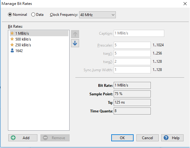

I used EVM board and PCAN-Viewer to verify CANFD_MCANFrameType_CLASSIC/CANFD_MCANFrameType_FD.
CANFD_MCANFrameType_CLASSIC TX/RX works fine.
We can receive CAN-FD data from PCAN,  but PCAN cannot get any data from EVM.
CANFD_transmitData() always returns 0, but there is no any interrupt.
I don't change anyCAN-FD parameter.
mcanBitTimingParams.nomBrp = 0x2U;
mcanBitTimingParams.nomPropSeg = 0x8U;
mcanBitTimingParams.nomPseg1 = 0x6U;
mcanBitTimingParams.nomPseg2 = 0x5U;
mcanBitTimingParams.nomSjw = 0x1U;

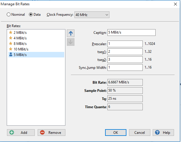

mcanBitTimingParams.dataBrp = 0x1U;
mcanBitTimingParams.dataPropSeg = 0x2U;
mcanBitTimingParams.dataPseg1 = 0x2U;
mcanBitTimingParams.dataPseg2 = 0x3U;
mcanBitTimingParams.dataSjw = 0x1U;
Do you have any idea for this?  Thanks.
And here is my PCAN settings.
