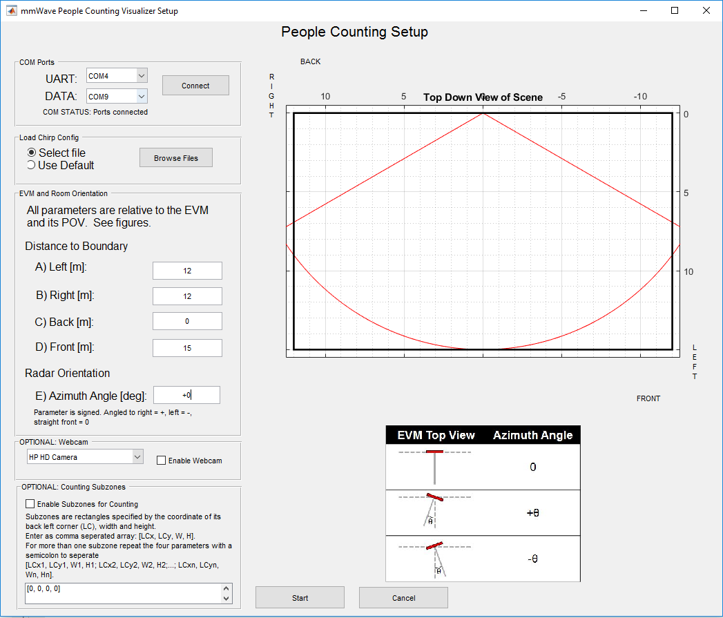

I'm trying to operate and visualize the People Counting Demo with the 14 [m[ range configuration supplied in TI's
website (attached in message body).
When I work with the default configuration ( 6 [m]) everything looks fine, but, when
moving to the 14 [m] all the detections arrive are in the range <= 6.4 [m].
I run the demo through Matlab with "main_pplcount_viz.m" script.
actually, It looks like the radar detects targets in all ranges up to 14 [m] but it maps the
targets to the close range.
For example: a target that exist in 14 [m] is shown in 6 [m].
a target exist in 5[m] will be shown around 2 [m].
