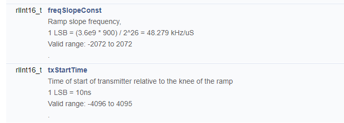

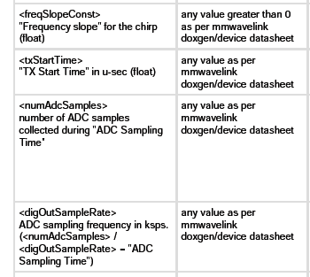

please let me know what are values of following. this is based on profile configuration.
frequency slope, <txStartTime>, <numAdcSamples>, <digOutSampleRate> and etc. when i refer the user manual, it advise to refer the mmwavelink. after refer mmwave like, it is total different. ( considering  the profileCfg 0 77 429 7 57.14 0 0 70 1 240 4884 0 0 30, data sheet is correct. but doesn't have values.) please let me know how to get correct details.
