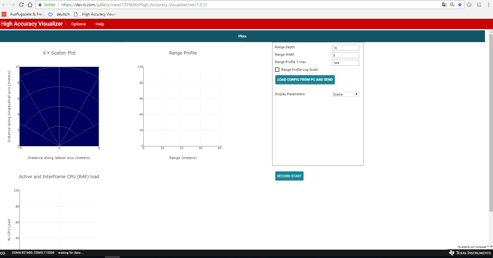

  • Hi Akash,
    i will start another discussion for this topic.
    But for the High accuracy Visualizer i have now a Problem. At the beginning of my test that works everything fine. But now i do everything is explaned in "high_accuracy_16xx_lab_user_guide" again and it dosent work (see screenshot i attach). At the Bottom of the window you can see that the Programm is waiting for data. What does it mean for me, what i have done wrong? Did i Forget something? I do the same as at the beginning but the messurement doesent start!
    Can you please help
    Thank you
    Best regards
    Mexhid
  • Hi Mexhid,
    I'd recommend ensuring that you have the correct COM ports elected in the options tab. It would also make sense to ensure that you have flashed your board with the correct High Accuracy binary file. Are you using the correct chirp configuration after pressing the Load Config button? Which version of the mmWave-SDK are you using?

  • Hi Akash,
    the COM ports are  correct.
    device Manager:
    Serial ports configuration TI:
    On the board i flashed the file  ,,xwr16xx_high_accuracy_lab.bin" and load the chirp configuration ,,accuracyTest1.txt".
    To start the configuration i use the link
    dev.ti.com/.../
    At the end i have the same Problem i explaned you at the post before:
    Best regards
    Kurtolli

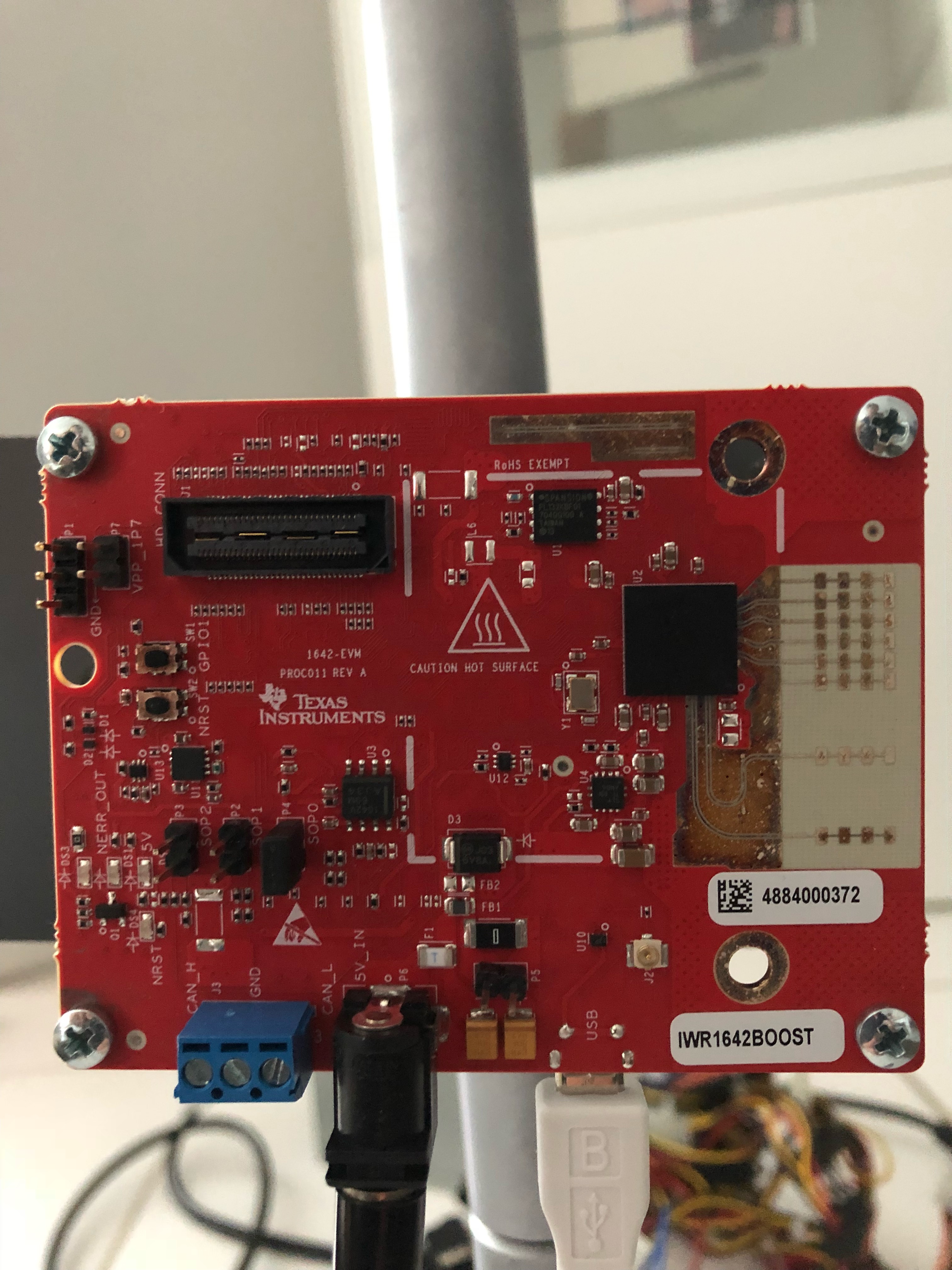

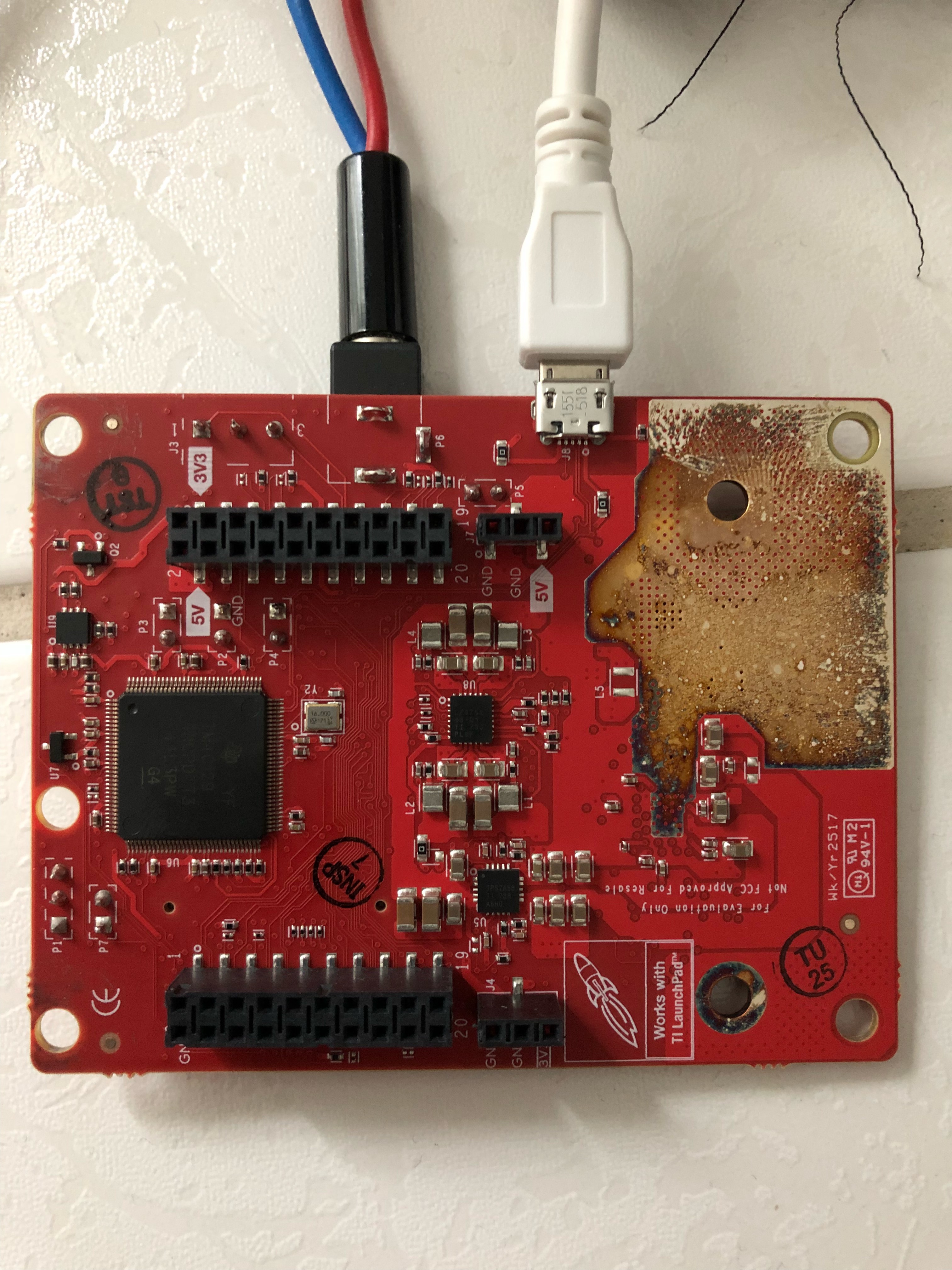

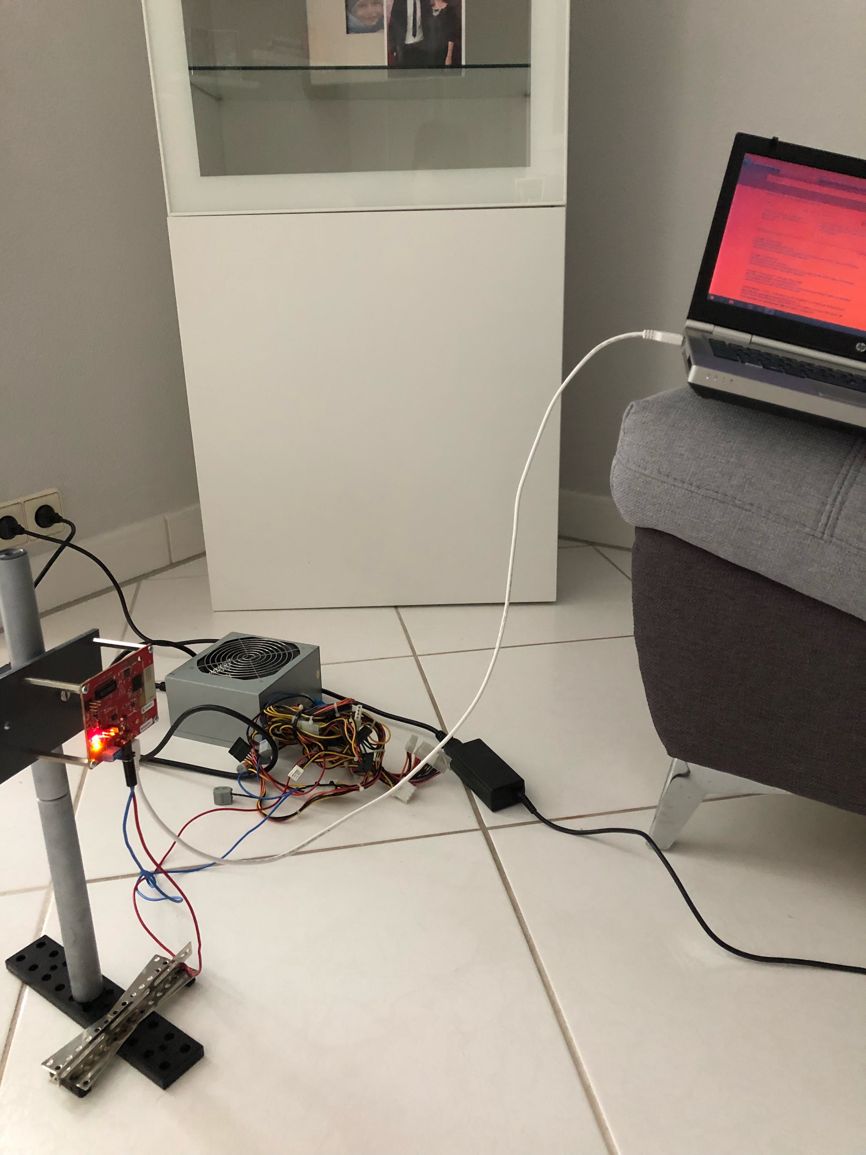

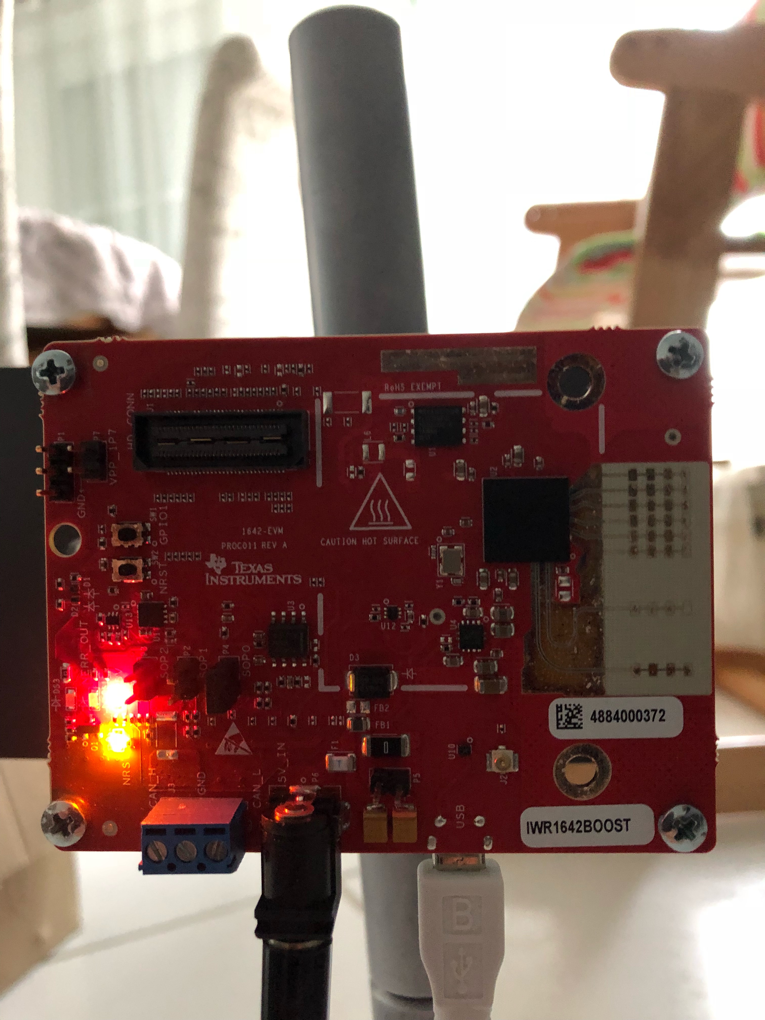

    We'll need more information in order to assist you. Would you be able to include a picture of both your board and your test setup?
    Cheers,
    Akash
  • Hi Akash,
    i done some Pictures. I hope ist ok.
    Best regards
    Mexhid
  • Hi Mexhid,
    Well this isn't at all expected behavior but it is interesting since you were able to get the High Accuracy Lab working not so long ago.
    Thank you for the pictures, there doesn't appear to be anything wrong with your board although I'd recommend testing it with another lab from the Industrial Toolbox. Does it work with the standard SDK demo or the Zone Occupancy Demo? If it doesn't work for either then it may indicate a problem with you board. If it doesn't work for just the SDK demo then there could be a problem with your browser or your machine.
