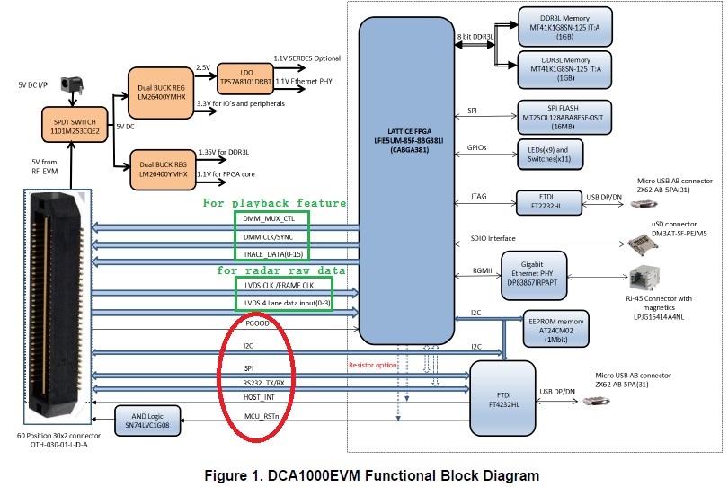

    Q5. if Q1's answer is yes, as customer wants to use DCA1000 EVM with their own board, they wants to only connect the signals which are useful. Can they remove below signals in red circle?
    If customer wants to use the playback mode which will be supported later, do they need to keep the I2C signals? Or any other signal in red circle need to keep?

    As to your added question, for the customer board, how do they plan to communicate with host? no SPI, UART or I2C needed, no interrupt or reset needed? PGood may be removed, but the FPGA image needs to be modified.

    From top diagram, I can see PGood goes into FPGA. It's a possibility that FPGA will check PGood signal before running. I haven't got to check the FPGA code yet.

  • Q6: If customer can only connect IWR1642's LVDS, UART, SPI signals to DCA1000, can DCA1000EVM work ok with customer's board?

    The statement about FPGA checking PGOOD status is based on the assumption that DCA1000 function inherits from IWR+DevPack+TSW1400, where PGOOD signal is required. I can also double check with designer.
    For Q6, I'll get back to you with designer's confirmation.

  • Chris,
    As for the pin connection, at least RSTn, PGOOD and HOST_INT (this is part of SPI) needs to be connected. I2C and DMM is optional.
    Let me know if you have any other questions.

  • Michelle,
    Thanks for your help! Would you pls help to double check if my below understanding is correct?
    With hardware configure mode of DCA1000 EVM and customer's board:
    1. if customer only wants to support LVDS data capture, LVDS signals/RSTn, PGOOD, HOST_INT must be connected. Other signals on connector are optional.
    2. If customer wants to support playback feature too, DMM signals should be connected.
  • Chris,
    Correct.
