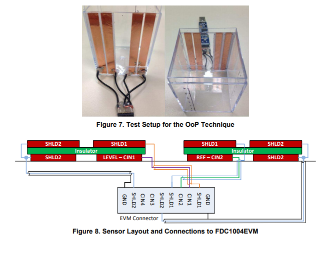

FDC1004  when used as water level sensor,  4 electrodes have been used as shown in videos and demos.
2 electrodes for reference and level i understand. Are the remaining 2 electrodes connected to shield or Ground pins of the FDC1004?
Kindly reply. we are stuck here
