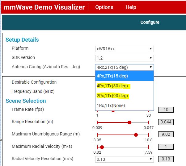

  • Hi Naz,
    In the Visualizer, we have the default 1TX2RX setting. You can try it for verification. Thanks.

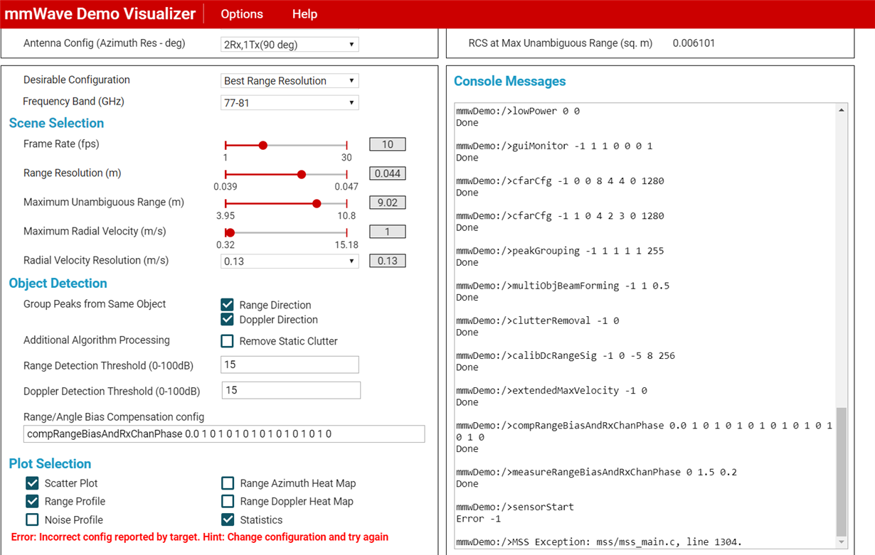

  • Hi  Wesley,
    I have tried this channel 3 1 0 cofiguration. And i saw this error in the following ficture:
    Sensor is not starting. Can you give me any information in this error?
    Naz

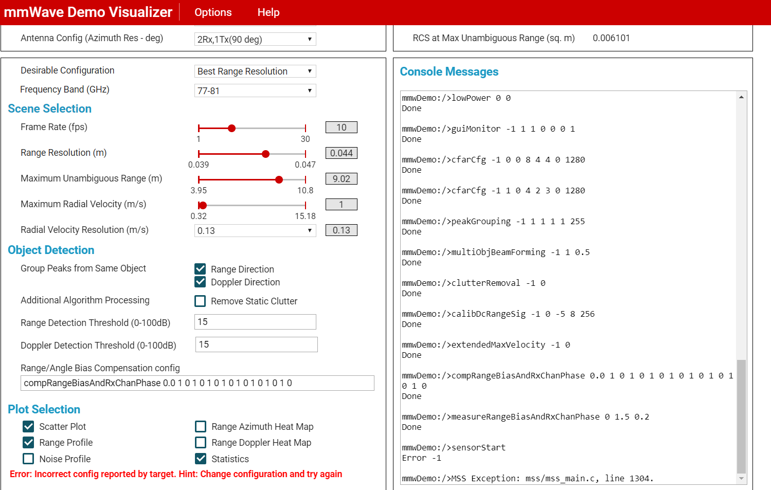

  • Wesley,
    I have sent this configuration in the online and offline GUI:
    mmwDemo:/>% ***************************************************************
    Skipped

    mmwDemo:/>sensorStart
    Error -1
    mmwDemo:/>MSS Exception: mss/mss_main.c, line 1304.
    I have have this error both of gui configurations. Sensor is not working. I have saw the following error:

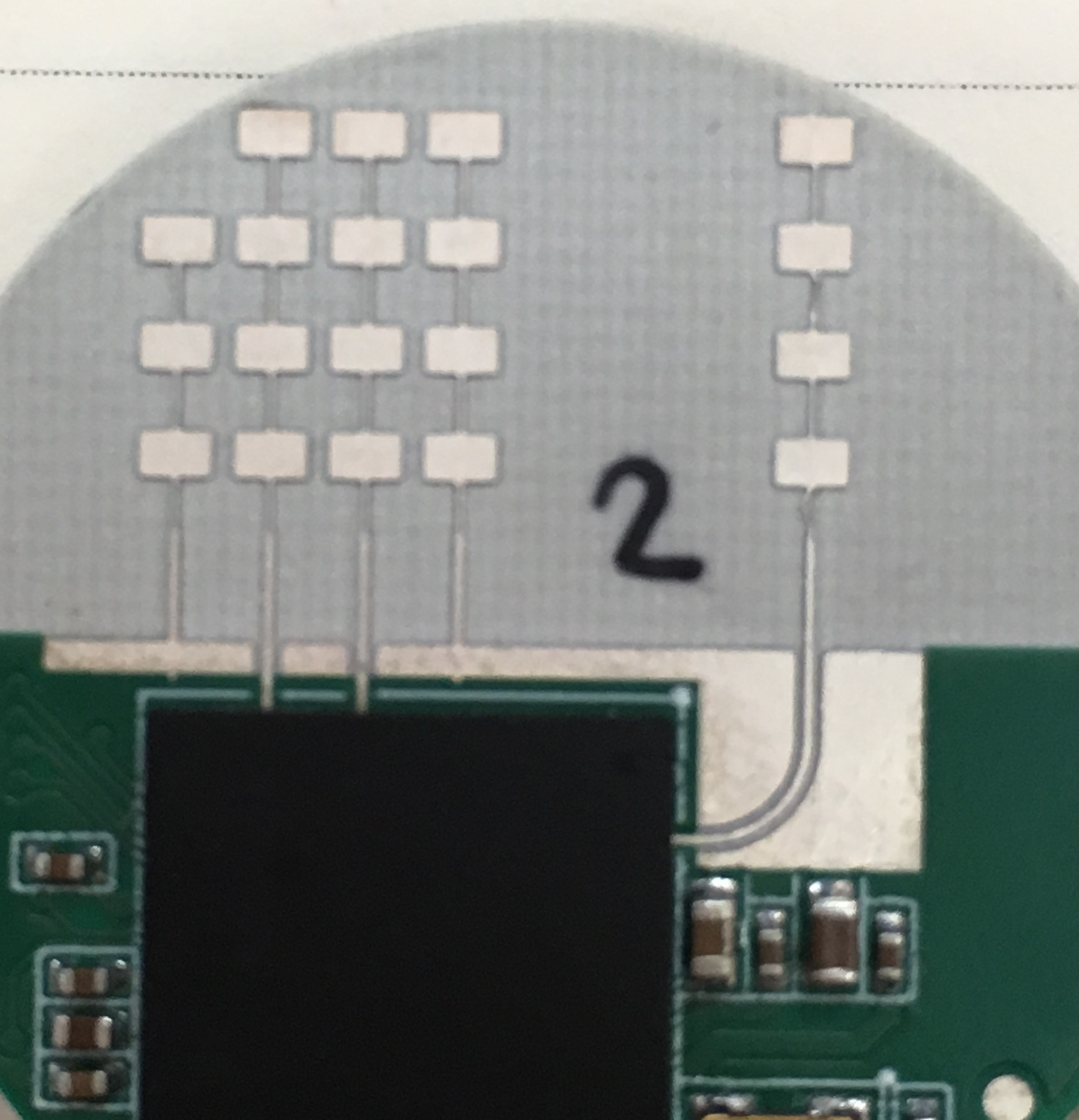

    I think i gave wrong information on my project. My project like in this following picture:
    So i have only 2RX and 1 TX antenna channels.

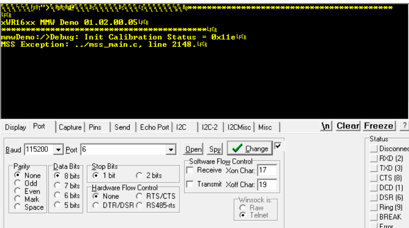

    I have wrote .bin file (in the SDK 01.02.00.05 version) in the QSPI flash using uniflash program. And I have loaded source code(in the SDK 01.02.00.05) in the iwr1642 using CCS. Then I have tried to run sensor using mmWave Visualizer online and offline version,but sensor didnt work.
    When i sent to channelcfg 3 1 0 (for 2RX and 1TX channel)and sensor want to start i have see this error:
    xWR16xx MMW Demo 01.02.00.05
    mmwDemo:/>Debug: Init Calibration Status = 0x11e
    MSS Exception: mss/mss_main.c, line 2148.
    I have checked AR_RS232TX,AR_RS232TX and AR_MSS_LOGGER connection but i couldnt see any mistake.
    Could you  suggest any idea for me?

    The error indicated shows that the BSS tried to do a calibration.    If you download Radar Studio or mmwave studio, under the c:\ti\(install folder)\docs, there is an ICD document that has more information.  Under Calibration mask  (AWR_RF_INIT_CALIBRATION_CONF_SB function, the Calibration return value, is supposed to have a value 1 for OK.  Check the line of C that is indicating a problem.
    Note: if you have an IWR1642 ES2 you need to use a different Uniflash, file, and a different mmwave SDK vs IWR1642 ES1 (older EVM).
    In the case of IWR1642, please check the device revision.   There are special requirements for ES1 - which includes the BSS+MSS+DSP, while the newer ES2 requires a BSS patch (not complete code) + MSS+DSP.  There is a different mmwave SDK version for this.
    You can tell the version by looking at the part labeling, or electronic signature with CCS.
    Part marking - The device has a "502" marked in the lower left corner (dot marking is upper left corner) for ES1 - should match you older EVM
                            "502AC" this is an ES2 released part.  you need to use the different mmwave SDK for this part.

    The calibration error is causing the mmwave software not to run the radar.  0x11e indicates that several of the calibration commands failed.
    If I flash the 1.02.05 mmw demo software on the EVM, and run the Visualizer with 1.2 SDK ver, best range resolution.  The Calibration status in the terminal window is
    Debug: Init Calibration Status = 0x7fe
    I have saved the EVM configuration file, and modified ChannelCfg 3 1 0 - to correspond to Rx1, Rx2, and Tx1 active
    Changing the Chirp configuration as there is no Tx2
    change the frameCfg to loop over chirp 0 only for 32 cycles.
    Looking at your picture, there is stripline delamination for the Tx antenna.  The stripline near the antenna should be straight.
    Done
    In your case you have reported, mmwDemo:/>Debug: Init Calibration Status = 0x11e
    this means calibration has failed for  bits, d11, d10, d7,d6,d5
    Using the Radar Studio ICD document, and the mmwave SDK User Guide, I have attached the modified Visualizer configuration which runs for the EVM
    the calibration status should be 0x7fe.

    I will ask the design engineer, the calibration may be affected by the number of connected Tx and Rx ports.
    On your board you can check the following
    I will use the IWR1642 BOOST EVM schematic as a reference, please also review the IWR1642 Hardware Checklist -
    please check that the power supplies meet the intended voltage
    - 3v3, and 1v2 are used for digital core - follow 5% specification limit for setpoint, ripple, and noise tolerance
    - 1v3_RF1, 1v3_RF2 - 1.3v 5% tolerance, datasheet table 5-2 for 1v3 ripple and noise
    - 1v8, several loads, we can check one supply connection 1.8v 5% tolerance, datasheet table 5-2 for 1v8 ripple and noise
    There are internal voltage regulators, these can be checked at the external bypass capacitors (I am referencing the EVM schematic IWR1642BOOST.
     AR_1v4_Synth C14 - should be 1.4v +/- 5%, ripple and noise should be within the Table 5-2 ripple and noise for 1.8v  (voltage is 1.4v)
      AR_1v4_APLL C13 - same as above
      AR_VOUT_PA - 1v - should have ripple and noise within Table 5-2 for 1v
    Also please check multiple boards, if you have the same error.

    I have checked 3V3,1V2,1V3 and 1V8 voltages. All of them is correct.
    I have checked the other voltages:
    -AR_1V4_SYNTH and AR_1V4_APLL voltages is equal to ~1.4V.
    -AR_VBGAP and AR_VOUT_PA voltages is equal to ~0.9V.
    I have checked the hardware checklist but i didnt see any mistakes.
    I will ask the design engineer, the calibration may be affected by the number of connected Tx and Rx ports. -->  Did you ask this question?
    I  have saw ICD document, how does should i BSS configuration change?

    The BSS software engineer indicates you should be using DFP 1.0 or greater.
    Please check that on your hardware module, Rx3, and Rx4 should not be floating, they should be tied to GND or to a 50 ohm resistor to GND.
    Tx2 as an experiment can be tied to a 50 ohm resistor to GND.
    If you look at the ICD document, there should be a function when you set the mask for calibration.   The current mask should be 0x7fe,  In your case with
    0x11e, there are several failing tests.  Trace through the software and set the calibration mask to 0x11e, before running the calibration API.  This is only for debugging, but should allow the RF initialization.
