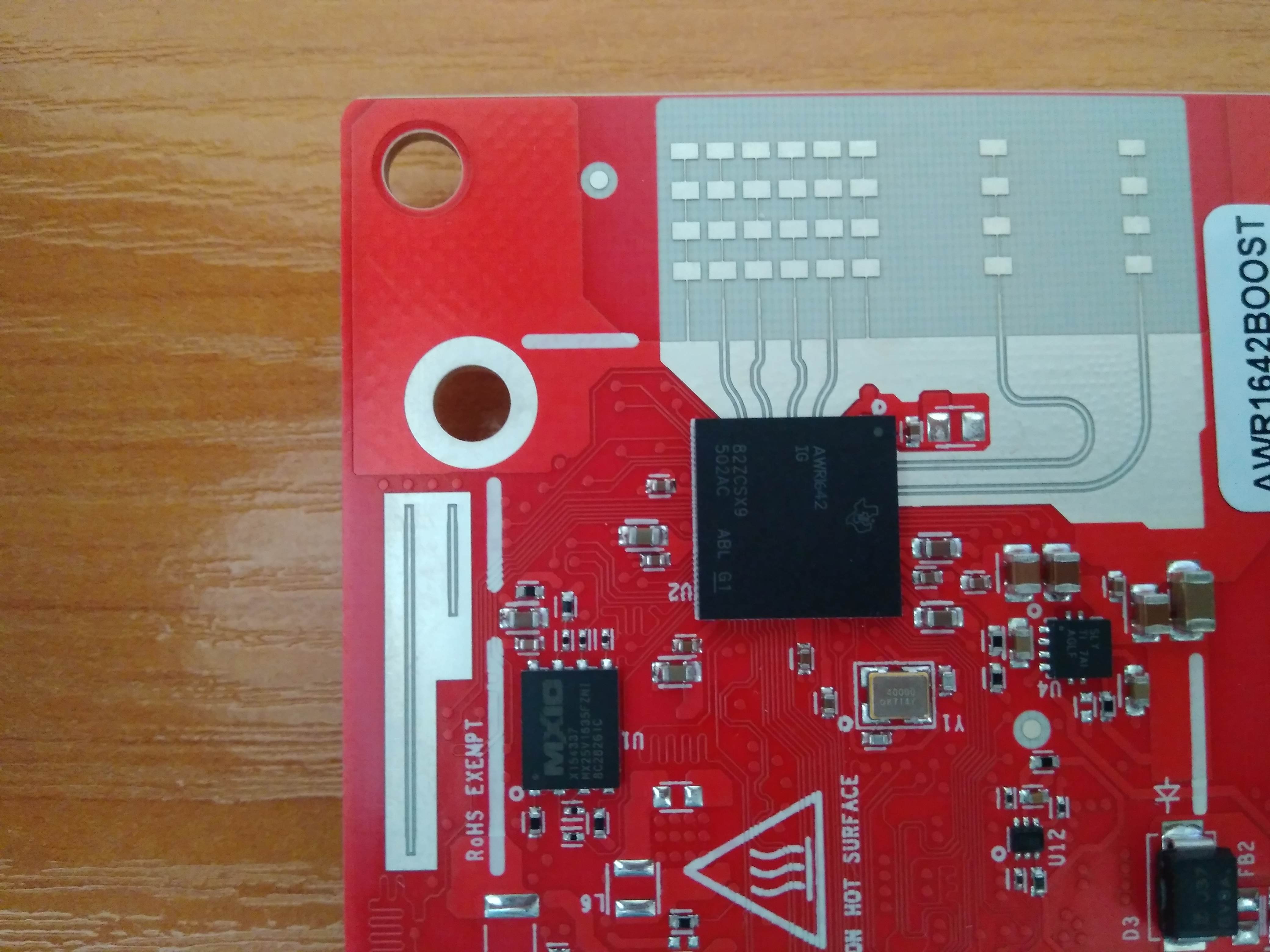

  • Settings from the CFG file I send via the UART port and if the sample is loaded in debugging I see in the console that the radar is tuned. I retrieve data from the data port.Matlab R2017a. I attach the photo of the chip since I did not really understand how to determine the version ES2.0 or ES1.0.Tell me where it's more convenient to send the video so you can see it.

  • Hi Konstantis,
    You have an ES1.0 board.  Make sure you are using Industrial toolbox 2.3.0, as 2.3.1 is built for ES2.0 and will not work properly with the ES1.
    Justin

  • Hi Justin,
    I wanted to clarify the revision of the chip. The thing is that I read in Device Errata,identifying number:-
    Line 4:
    – 502 = AWR1642 Identifier
    – A = ES2.0
    – BLANK = ES1.0
    on my chip 502AC.So it turns out that I have ES2.0.Could you specify how you determined that I have ES1.0 revision?
    С уважением,
    Константин Лыскин
    stremitelnu@mail.ru
  • You are correct. You do have an ES1.0.
