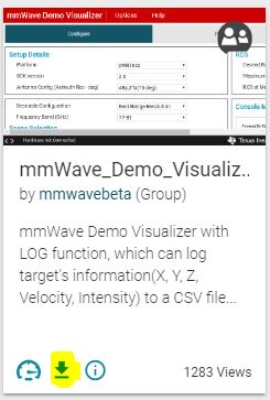

    There is a demo in beta that saves the recorded data to a human readable CSV file - you can read the code and understand the data conversion process:
    mmWave visualizer with the LOG function: dev.ti.com/.../

    Is that possible access to ti-gallery? You can search "mmWave visualizer with the LOG" in ti-gallery. Link:
    Also, you can download the offline version through ti-gallery.

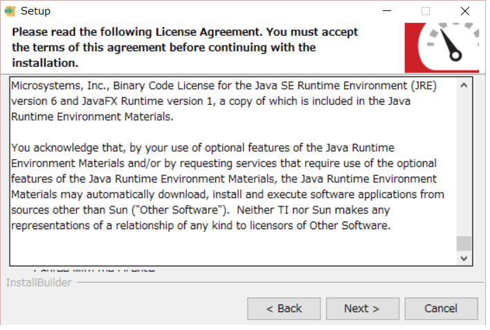

    Thank you very match,but the installer GUI is not correct.
    I can not scroll the GUI at "I Agree".
    I can not change the size of this screen.
    I changed my Windows10(64bit)  settings and display resolution, I can not  be able to see the part of the radio button.
    Please change your resolution setting of your PC and try again.
    If it doesn't work, please try another PC. Thanks.
    Wesley
    Thank you.
    It was not possible to display the radio button by changing the resolution
    in Windows or adjusting the hardware.
    However, when I repeatedly click the arrow key and the mouse click several times
    in the lower part of the screen, I was able to transition to the next screen by chance.
    I happened to solve this problem.
