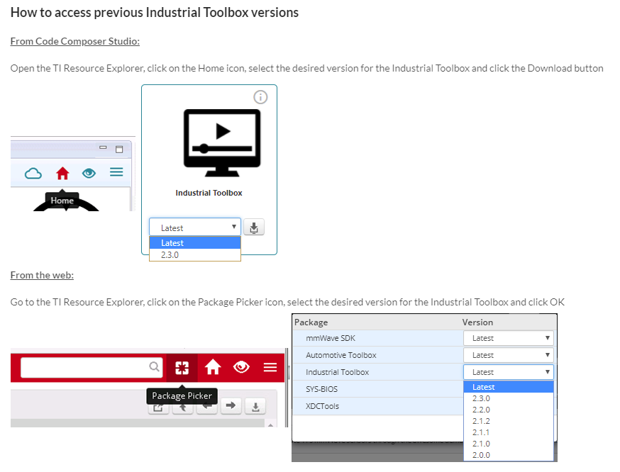

    If you can provide us with instructions how to download, compile and program the IWR1642BOOST ver 1.0, version 2.3.1 that can save us time.
    Thanks in advance
    Danny Braunshtein
  • Former Member
    0 Former Member in reply to Danny Braunshtein
    Danny,
    To download previous versions including Industrial Toolbox Version 2.3.1, please see the directions below. The, traffic monitoring lab there will have ES1.0 compatible software. You can then either use the pre-built binaries or compile from the CCS project.
    Amanda
