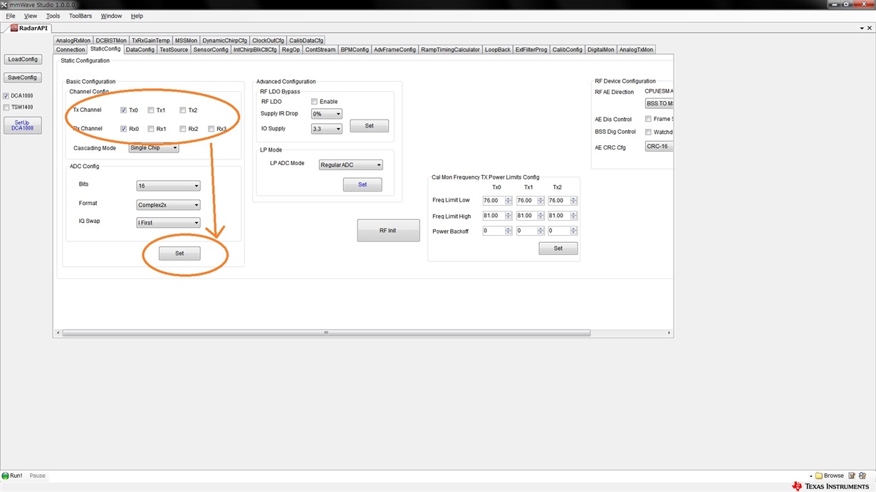

I'm trying to caputuer raw data. It was following mmWave studio GUI User's Guide.
I did User's Guide of Continous Streaming Tab Operation(page 28). But save files were almost 0 byte as bellow.
I'm not sure what is wrong. I want to know right operation and setting on DCA1000.

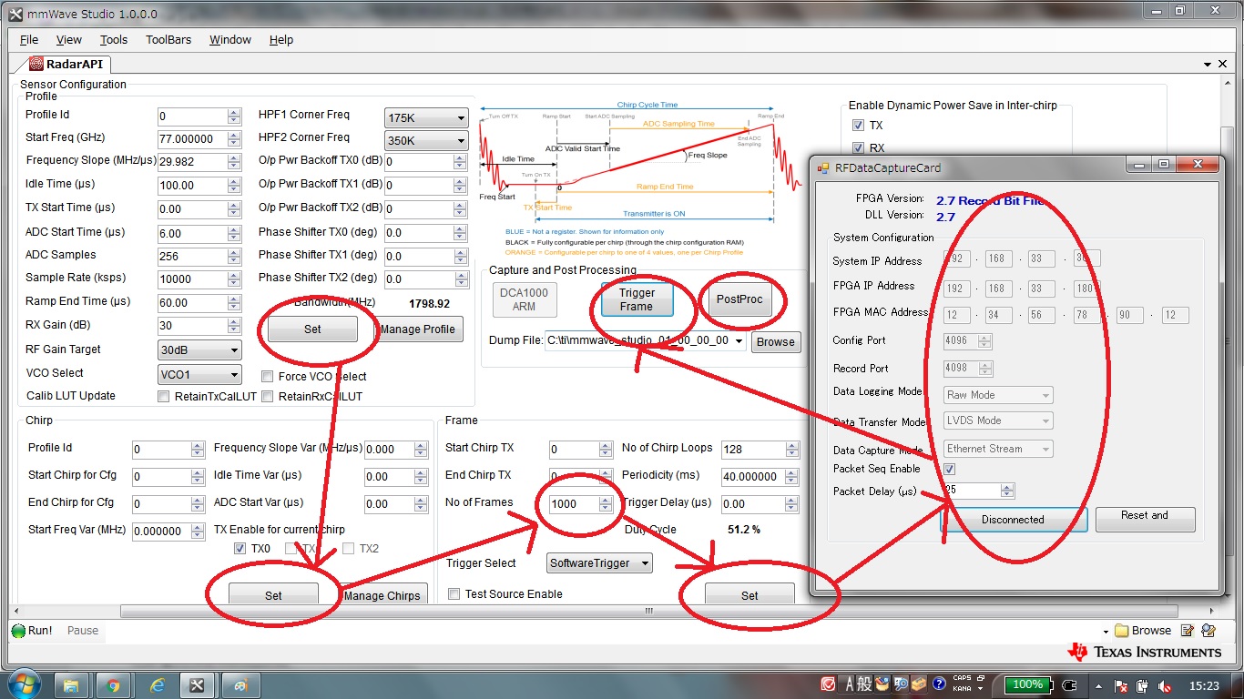

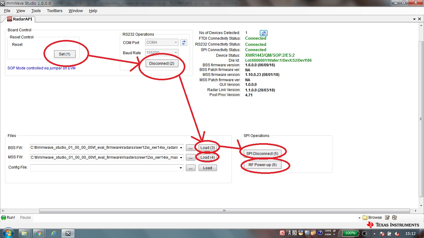

  • Hello Wesley,
    Sorry, my replying is late. I tried to set "SensorConfig". But There is error and few saved data.
    The following is my procedure. Please tell me what's wrong.
    1st
    2nd
    3rd
    4th
    Best Regards.,
    M.Iwasaki
  • Hi M.Iwasaki,
    In 2nd step, you should click ADC CONFIG-SET, then LPADC-SET, then RF_INIT.
    Also, you can open the view->output window, and it will give you warning if you did a wrong step.

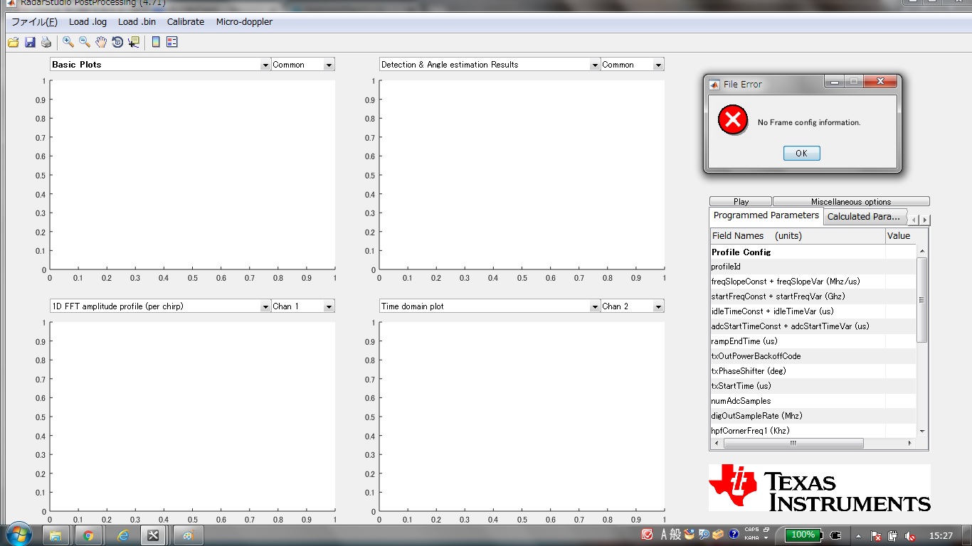

  • Hello Wesley,
    I watched the video and tried your comments. But it's not successful.
    I attachied the video I did. Please tell me waht's wrong.
    If possible,please email your video using DCA1000.
    Best Regards.,

  • Hi Mitsuharu Iwasaki,
    The step you did is correct. Please double check with listed items:
    • IWR1443EVM version, it should be ES1.0 or ES2.0, could you please follow the datasheet and double check with it? Figure 8-1 in link:
    • You can open View->Output window in mmWave Studio to check if the configuration is correctly or not?
    Wesley

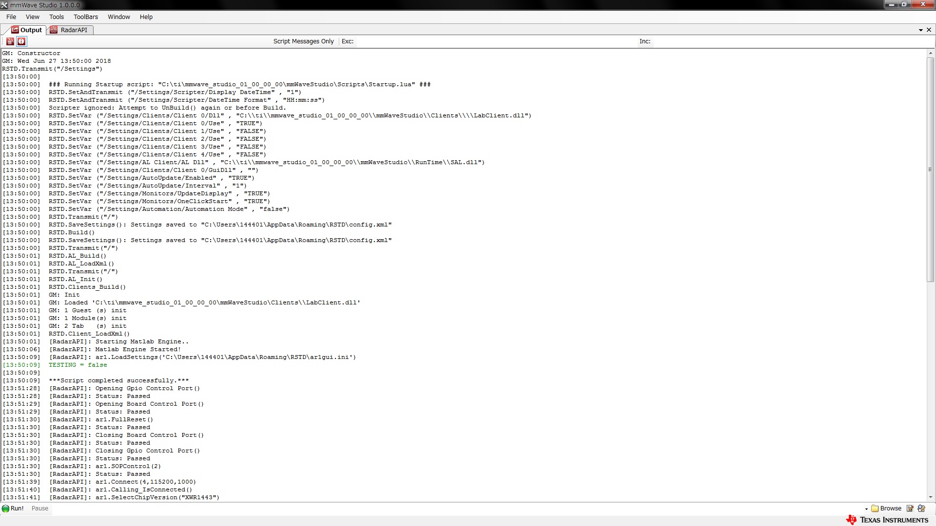

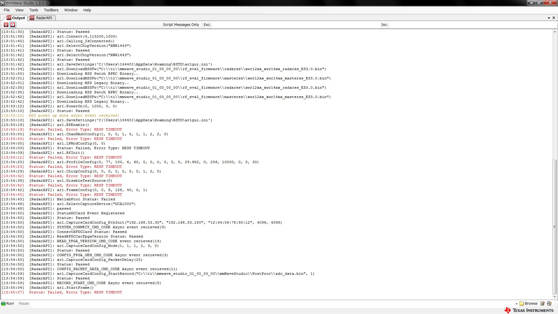

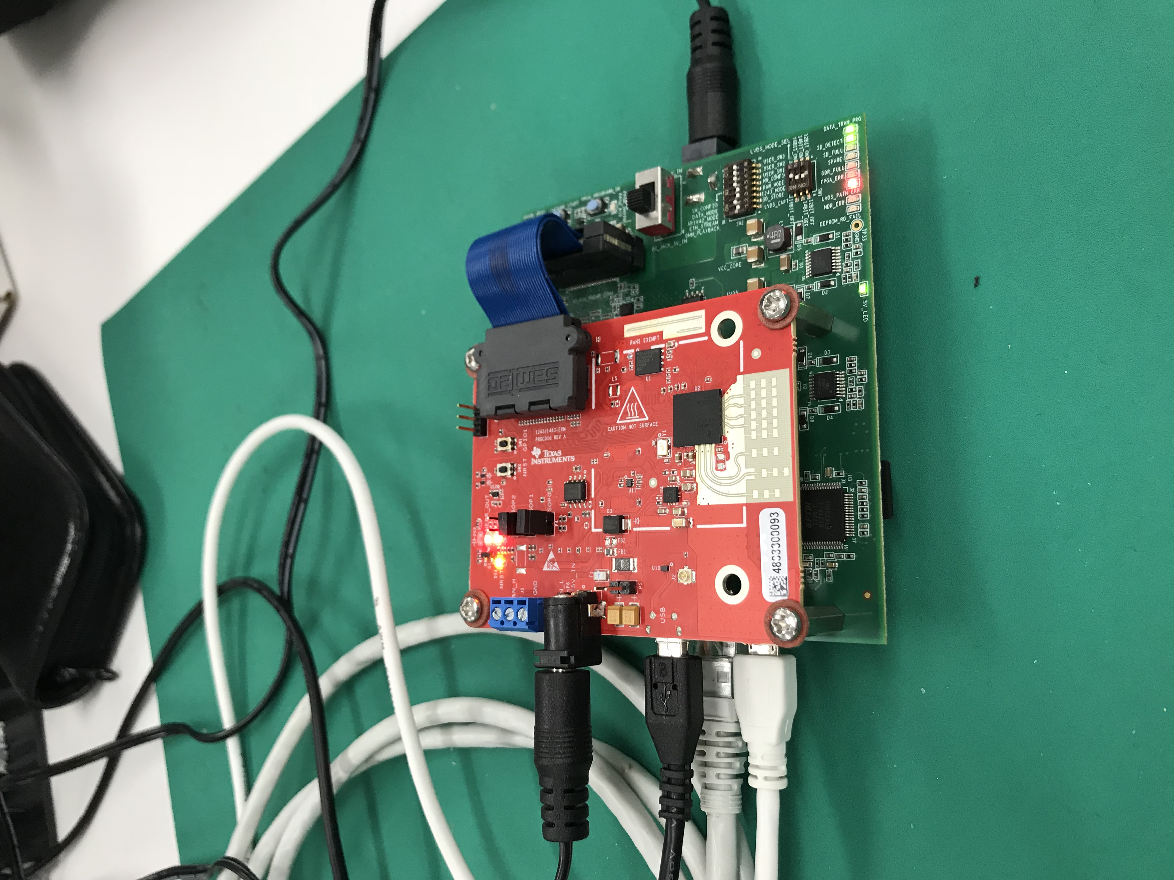

  • Hello Wesley,
    I attachied Output log and EVM photo. I found "TESTING = false" after mmWaveSTudio is launched.
    I have two IWR1443BOOSTs. I tried another IWR1443BOOT. But it has same message.
    Is jumper setting correct? Please give me comments about Output log and my question.
    Best Regards.,
    Mitsuharu Iwasaki
    END
  • Hello Wesley,
    I added to the privious reply. Our EVM is XIWR1443, QG, 74ZE0JQ,964D,ABL and G1.
    It's ES2.0.
    Best Regards.,
    Mitsuharu Iwasaki
    If you are using ES2.0 device, please use ES2.0 firmware.
    C:\ti\mmwave_studio_01_00_00_00\rf_eval_firmware\masterss\xwr12xx_xwr14xx_masterss_ES2.0.bin
    C:\ti\mmwave_studio_01_00_00_00\rf_eval_firmware\radarss\xwr12xx_xwr14xx_radarss_ES2.0.bin
    Thanks.
  • Hello Wesley,
    Thank you for suporting. Data capture is succesful.
    I have a concern. When mmWaveStudio is launched, there is the message as TESTING = false.
    Do I ignore it?
    Best Regrads.,
    Mitsuharu Iwasaki
    It's same in my laptop. It doesn't matter.
