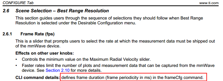

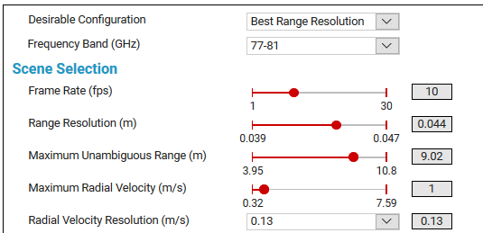

I read the mmWave Demo Visualizer user guide and I have a question.
As  the pictures shows,
the sequence of selections are  Frame Rate—— Radial Velocity Resolution —— Maximum Radial Velocity——Range Resolution —— Maximum Unambiguous Range ,when I choose the desirable configuration——Best Velocity Resolution, but the sequence will change when I choose the other desirable configuration such as Best Range Resolution.
I want to know what factors influence the selection sequence? How do you judje which parameter( such as Velocity Resolution、Maximum Radial Velocity、Range Resolution and so on ) determines the CLI command(such as freq slope、 ramp end time 、num of ADC sample、 idle time、 frame periodicity and so on )?
