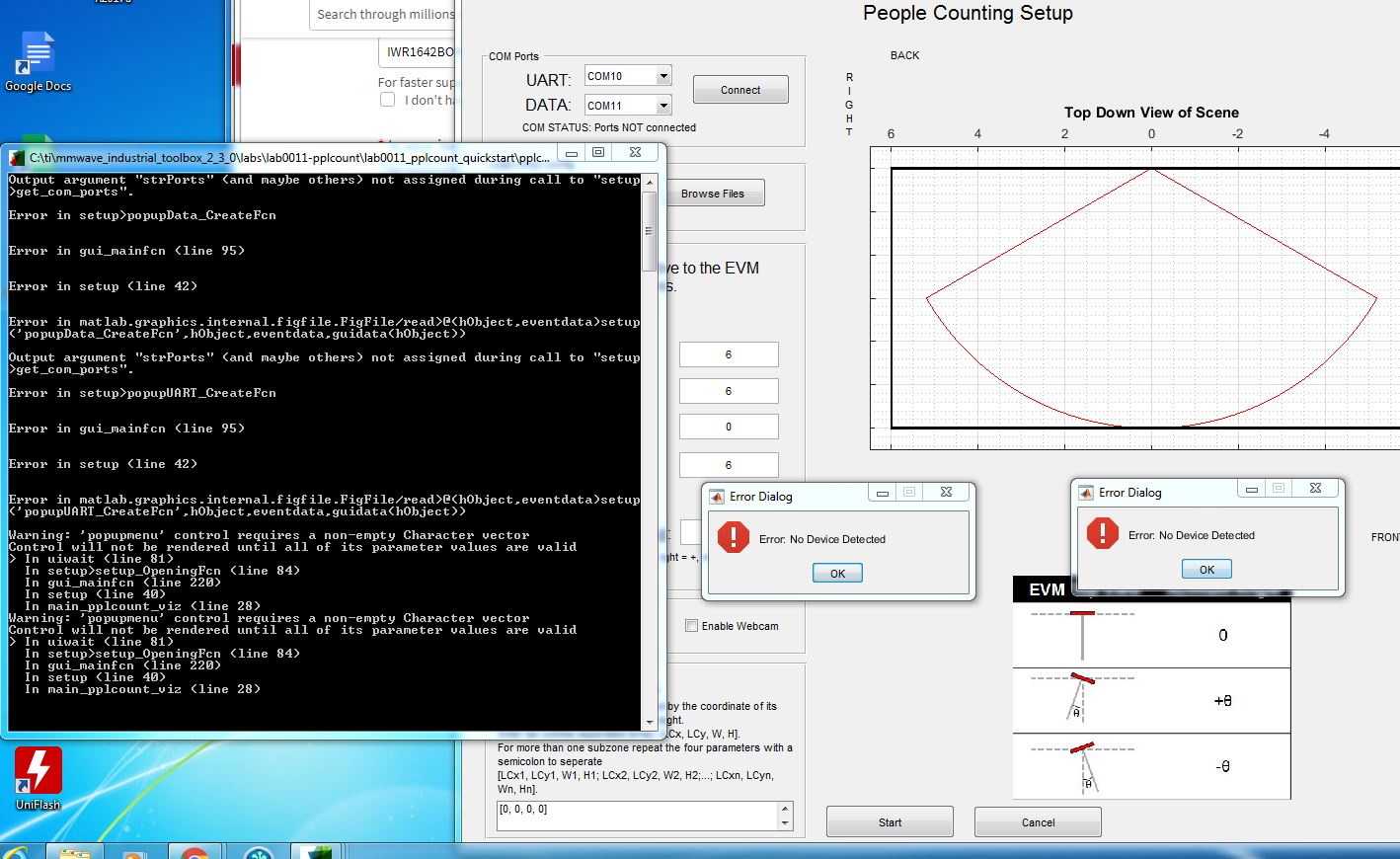

IWR1642BOOST: People count example does not start due to com ports issue
Part Number: IWR1642BOOST
I am running ES1.0 with SDK 1.2.0.5, Industrial toolbox 2.3.0
I have loaded the firmware on the EVM and when I try to start the application I get the following error
Initially the XDS110 port numbers were 5 and 4. the GUI still showed 10 and 11. I have changed them from the control panel to be 10 and 11. still the same problem.
I have also compiled the example and loaded it from CCS 7 and still have the same problem.
the mmwave SDK demo runs well.

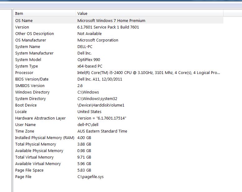

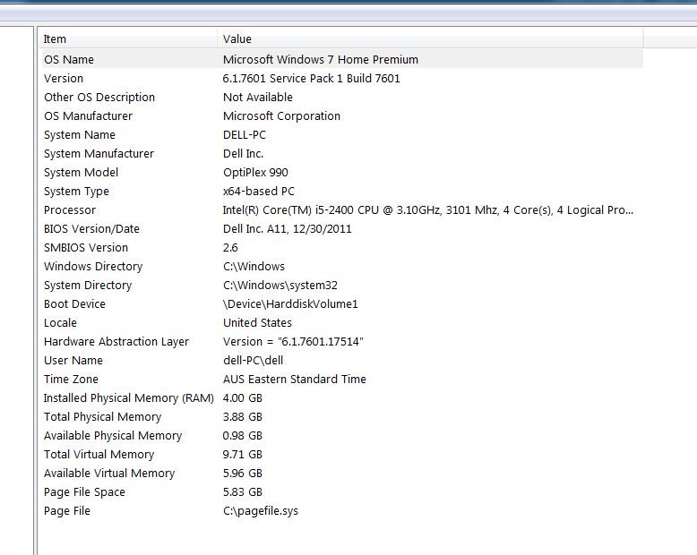

  • Can you let us know your PC(laptop) manufacturer and model number?
    Thanks and regards,
    Hayden Kim
  •  Please see attached
  • I saw the same issue with several laptop models (LG and Lenovo).

  • Hi Adrian,
    I believe the GUI is not properly detecting your device. This is why the GUI did not auto populate the correct COM Ports, and this is why the GUI cannot connect to the device. Please try running the GUI in admistrator mode to see if this is a permissions issue with windows.
    Justin

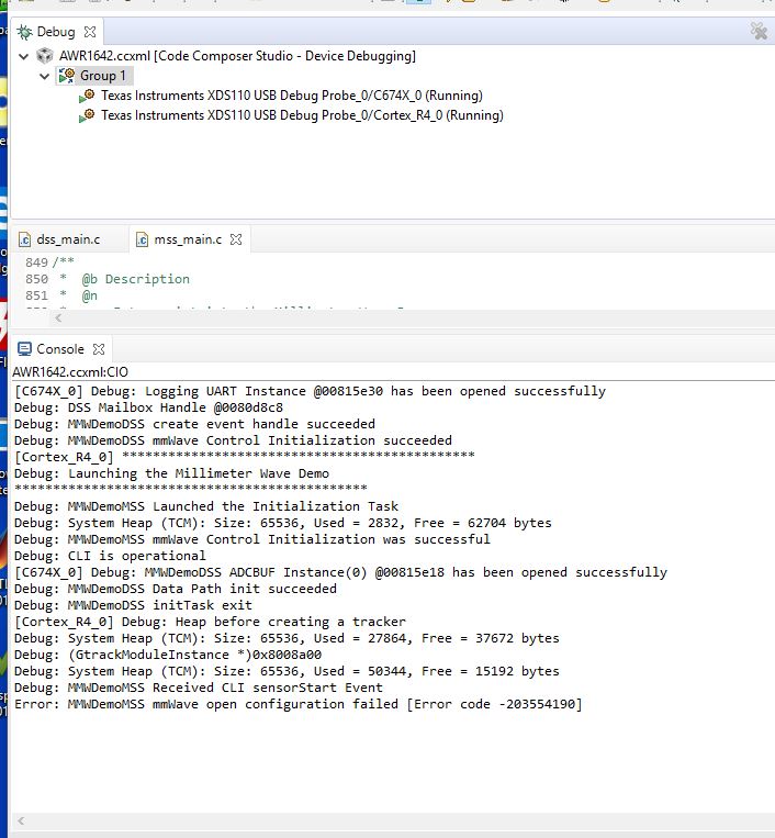

    1. If I don't power cycle the board from one session to the next I get the following error when loading the mss binary after connecting the target:

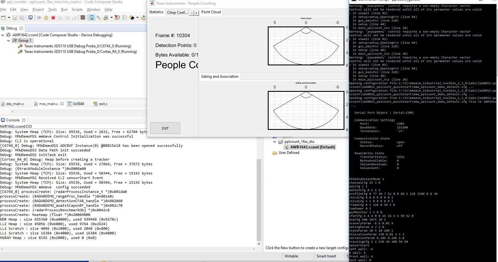

  • Hi Adrian,
    Sorry for the delayed reply. From the post on July 18th, it looks like the device is sending data back to the GUI, as the Frame Number is increasing. However, any movement in front of the device should cause points to appear on the GUI. Have you run the Out of Box demo on this board before?

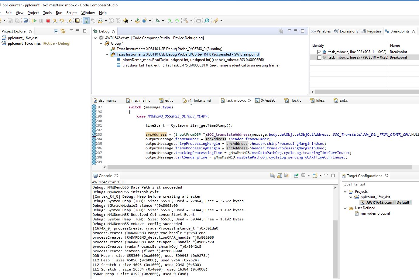

  • Hi Adrian,
    I believe you have an ES2.0 board now. Please ensure you are using a the new Industrial Toolbox, version 2.5.1 (2.5.0 and 2.4.0) are fine as well. Please load the pre-compiled binary on the device, and try running this with the GUI. If this runs, please create a new workspace in CCS, then follow the steps in the User's Guide to import and run the application. Ensure you use the debug binary from SDK 2.00.00.04 when you run with CCS.
    If this fails, please run the device in debug mode and put a break point at line 277 in task_mbox.c, in the MSS project. If the demo hits this break point, then your computer is not receiving data on the UART DATA port. If this line is not hit, put a breakpoint at line 203 in the same file, task_mbox.c. The demo will hit this breakpoint if the DSS is generating a point cloud.
    If this fails, we will need to check if the DSS is functioning. A breakpoint at line 1206 will get hit if the device is processing each chirp, and a breakpoint at line 1230 will get hit if the device is processing the frames. After the break point at line 1230, the outputDataToArm struct should have point cloud information.
    Please take these debug steps and let me know what fails.
    Justin

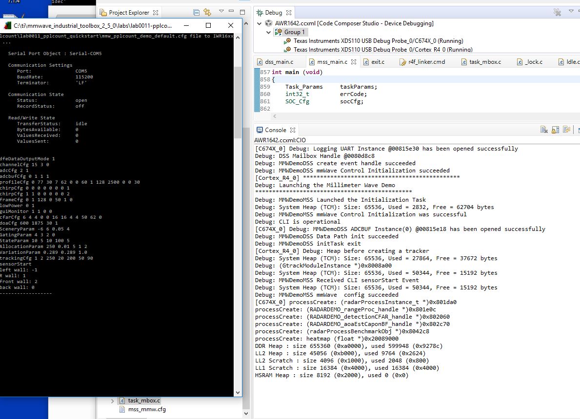

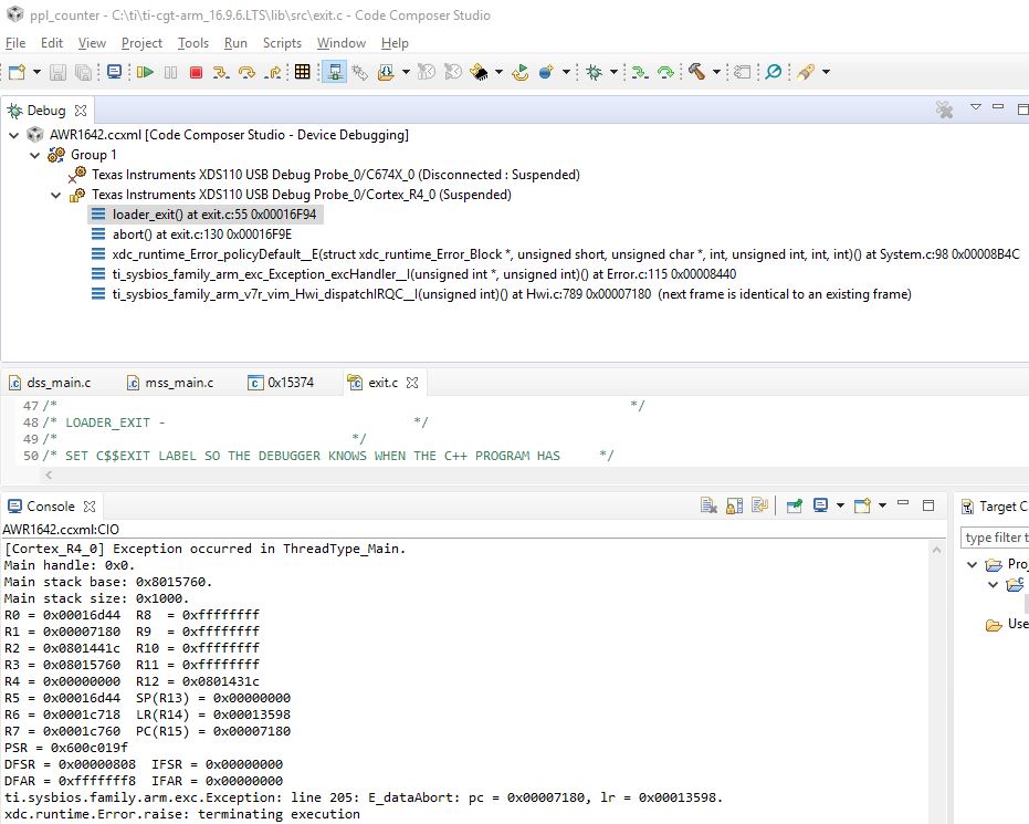

  • The application does not reach line 277 so probably the "length" is "0". It does reach line 203 but it is impossible to debug. As soon as it hits the break point the application crashes. I can not see see what is going on. How are you debugging this guys? The Matlab application crashes too as soon as you pause the radar application so it will be impossible to resume even if it worked. The Matlab application would have to be restarted and it will want to resend all the parameters again which the radar application does not support.

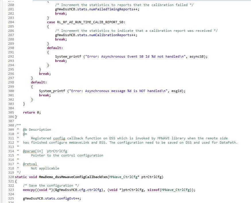

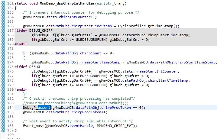

  • Hi Adrian,
    There are Asserts in the dss_main.c that are triggered when the device takes too long to process a chirp or frame. Anytime we stop at a breakpoint, the device will take too long to process the frame, and these asserts will be triggered.  Removing the asserts, or commenting them out, will not break the demo (if you are using the default configs), and will allow you to step through the program. You can find these at dss_main.c line 317 and line 288. You will also see a line number appear in the console when an assert is triggered.
    Please remove these asserts and try the debug steps again.  If possible, can you send me console output from matlab when the configuration is sent?

    I am using the default config file I found in the Industrial Toolbox 2.5.0. If I use the default settings without selecting a fileI get the high power mode which is one of the first faults you identified. So I have selected the default file. I also watched a webminar mentioning the four values that can be used for tuning and they said that on the forum somewhere there is an explanation of how they are used. Attached is the default.cfg file I am using.

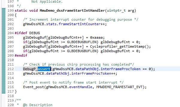

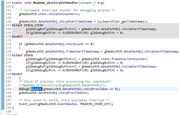

  • asserts,
    maybe we are not using the same main_dss file. I suspect the asserts you are referring to are at lines 188 and 212 as in the following two files attacted. I have also attached a dump of the lines 280 to 320 so you can see what it is there. Instead of the asserts I suspect the system should just wait for mss to finish the process even if it means it skips some frames. Otherwise it corrupts memory or at least this is what I think.
    Thank you for your support and apologies if my problems look simple for you but it is really hard when you are new to everything and nothing works. When things work you just concentrate on a small area of interest which you learn and understand and slowly solowly you expend your knowledge.
  • Hi Adrian,
    I believe I gave you the wrong line numbers, but it looks like you found the right lines.   We have chosen to add the asserts because we do not want to run a configuration that takes too long to process - we do not want to miss a chirp, otherwise our velocity calculation will be incorrect.   In the case that you are running in debug mode and sit at a specific line, only the ADC buffer will be overwritten, so you are safe to step through the code.
    I am worried that your BSS may not be running properly - understanding if the device is receiving the chirp interrupt will be helpful to me.  Here is a quick basic flow of the software:
    1) BSS generates chirp data, places in ADC buffer
    2) DSS reads from ADC buffer after each chirp and puts this 1D FFT data in a different buffer.
    3) DSS processes all 1D FFT data after the frame is complete. This results in detection points, which the device will send to the MSS
    4) MSS receives points from DSS, runs points through tracker
    5) Points and tracks are sent over UART by MSS.
    We are trying to find where this is flow is failing. Step 5 is not sending anything, because there is nothing to send.  These are the points I have asked you to put breakpoints at.  See if you can identify  the point will data stops flowing.

  • Hi Adrian,
    I have been able to reproduce your issue by changing the compiler I am using for the c6000. Please go into the DSS project in CCS and check the compiler version: Right click pplcount_dss_16xx->properties->General, then you will see the Compiler version in the bottom half of the screen.  This should be compiler version TI v7.4.16.  If it is not, you can find the download link here in the developer's guide section.
    Justin

  • Thank you Justin. It does work now. What do we do about the ES1.0 board? The other thread seems to be idle. No news that it has been fixed or not. I will tick this resolved my issue here but would appreciate if you had any suggestions about the original problem. I can't use the ES1.0 board
