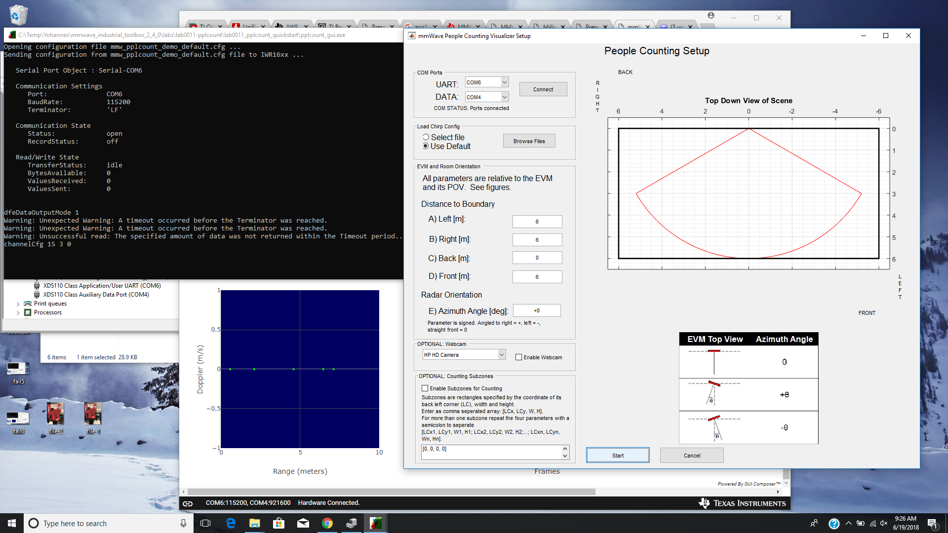

I am trying to run People Counting Demo with AWR1642BOOST with the pre-compiled binary. I downloaded the mmwave_industrial_toolbox_2_3_0 as my board is the ES1.0 rev. A version. There is no ES2.0 sticker on my board. I flashed the EVM with the Uniflash cloud version, and everything was successful. I made sure that the POS2 jumper is disconnected, and only POS0 jumper is installed, and power cycled the board. When I run the visualizer, and start the application, I am getting below error. The UART and DATA COM ports are connected in the status. Does this binary work with the AWR1642BOOST as is? Any idea what could be the problem? I have also tried with version 2.4, and it displays the same error.

  • Hello Amanda,
    Thanks for your reply.
    1. Yes, I made sure the COM ports are correct. In fact, when I opened the visualizer, it defaults to the correct ports, and there is no way for me to change it from the pull down menu.
    2. I don't have CCS installed, so I tried to run the lab0005-high-accuracy-16xx from SDK version 2.3.0, and it does not work also. The status says that it is waiting for data.

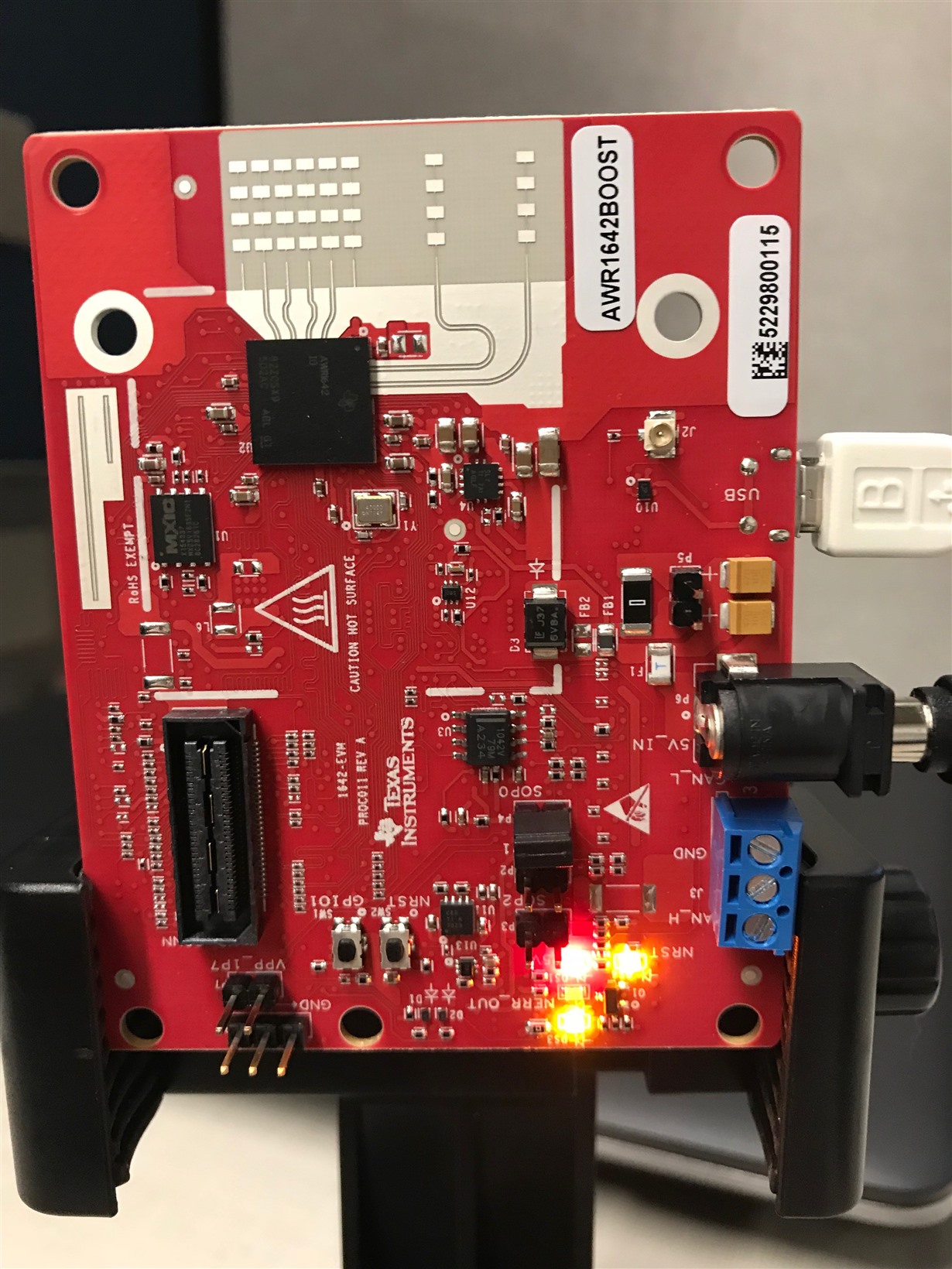

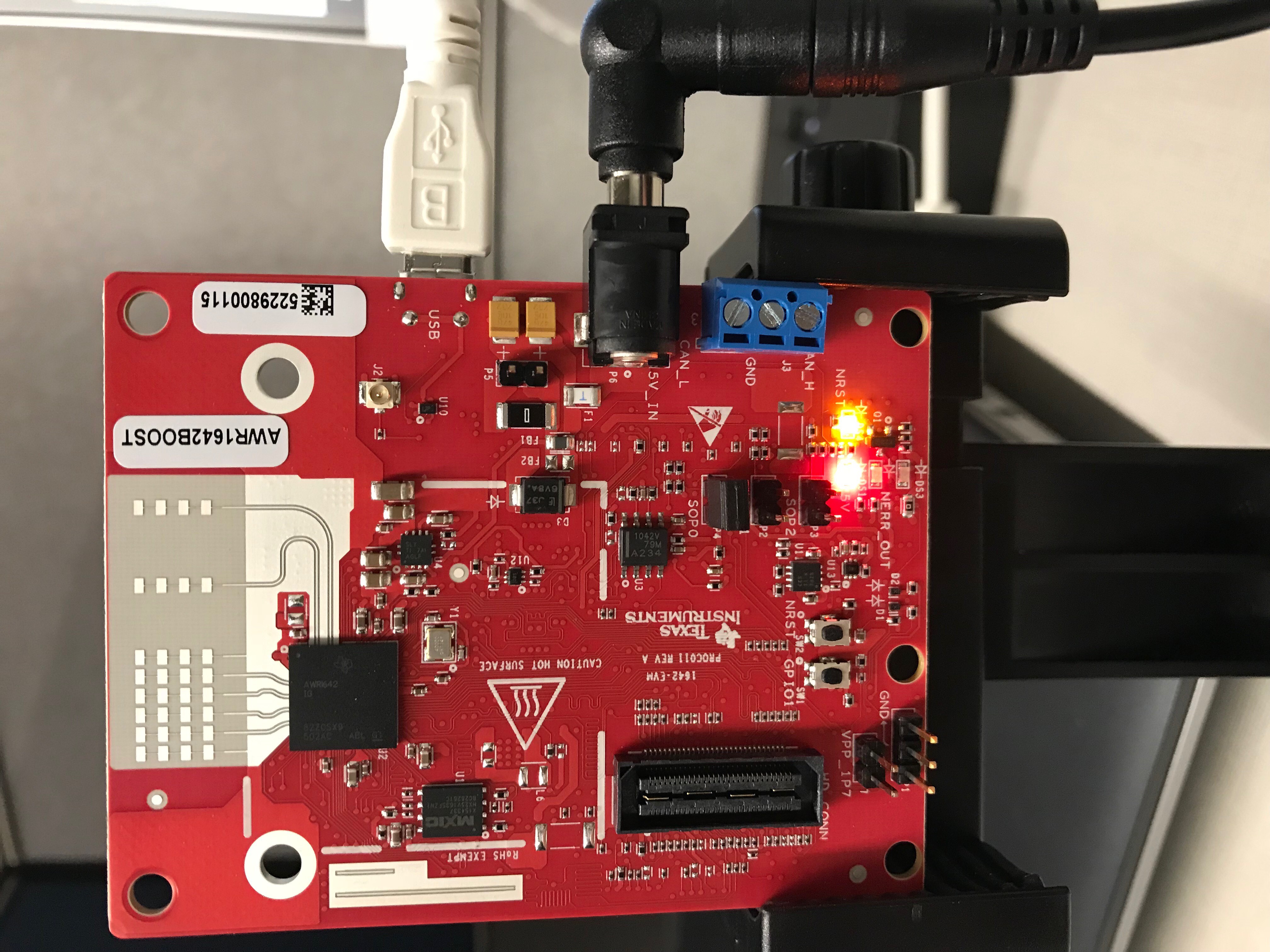

    If you received your board a few days ago, it is likely that your board is ES2.0 even though it is missing the sticker. Can you check the device markings on the package of the chip does the bottom left corner read "502A" (ES2.0) or just "502" (ES1.0)?

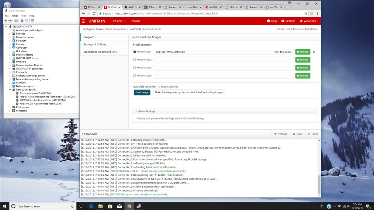

    Using, uniflash you need to flash the xwr16xx_mmw_demo.bin found at C:\ti\mmwave_sdk_02_00_00_04\packages\ti\demo\xwr16xx\mmw

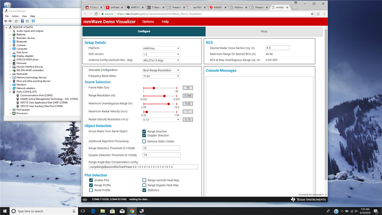

  • Hello again,
    Just wanted to give an update on what I have tried this morning, and still no luck. In order for me to run the OOB demo, I downloaded and installed mmwave_sdk_01_02_00_05, and flashed the EVM with the xwr16xx_mmw_demo.bin found under the .../packages/ti/demo/xwr16xx/mmw directory. Flash procedure was successful as seen in the screen shot.
    I then removed POS2 jumper, recycled the power, and hit the reset button until the yellow LED turn off and back on.

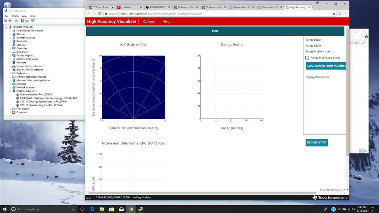

  • I launched the visualizer, and the status indicates "waiting for data". Note that the COM ports match with what shown on the device driver. It seems that I have received a defective EVM with my purchase. How do I process the RMA (I purchased this board from Mouser Electronics).

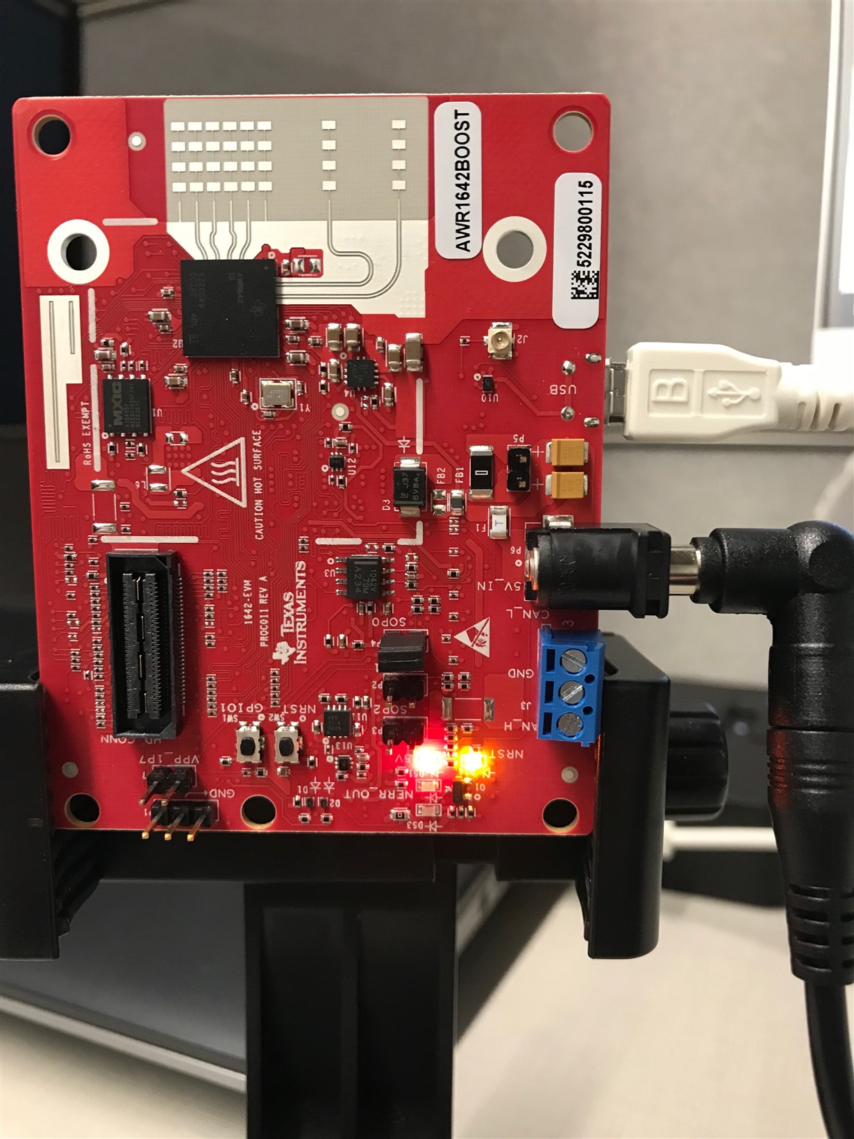

  • Former Member
    0 Former Member in reply to Yohannes Solichien
    Thank you for attaching the image. From the device package, you have an ES2.0 board and will need SDK 2.0.0.4 it will not work with 1.02.00.05. Please download the SDK latest here and try the out of box demo: software-dl.ti.com/.../index_FDS.html

  • Amanda,
    Thanks for your suggestion. I believe you're right that my board is an ES2.0 based on the marking on the chip. I followed your suggestion to run the OOB demo with the 2_0_0_4 SDK version, and at least I am getting some data back to the PC. I did get an LED error lit up consistently when I run the demo (see picture). I am not sure what this error means though, you have any clue?

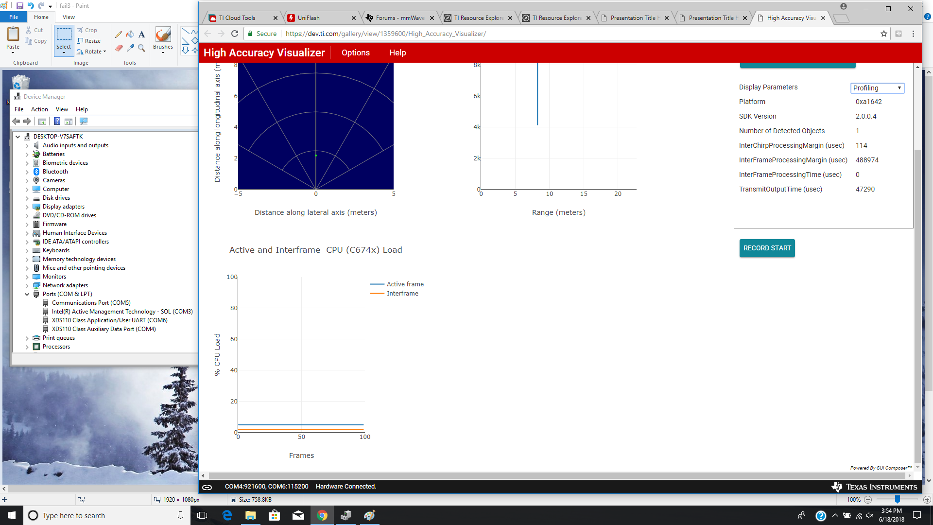

  • Hello again,
    The out of box demo works with SDK2.0.0.4, with the exception that the NERR_OUT LED was turned on. The visualizer was also indicating that it detects objects, although I did not spend too much time testing it.

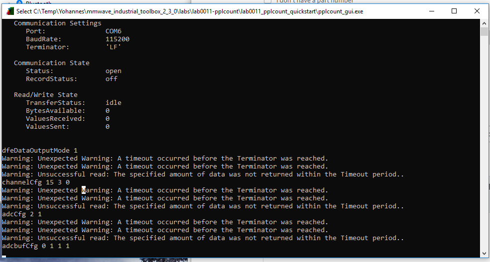

    I downloaded mmwave_industrial_toolbox_2_4_0, flashed the ..../lab0011_pplcount_quickstart/xwr16xx_pcount_lab.bin, removed POS2 jumper, and recycled power, but ran into the same problem. The fact that I can get data back with the OOB demo, but not with people count demo points to there are certain settings that is not correct with this demo. Any suggestion I can try?

    Can you try closing the mmWave Visualizer (closing just the tab is is ok) and then launch the people counting again? Sometimes when the demo visualizer is open and running first the people counting visualizer can see that the ports are open and connected but can not take control to send the people counting configuration.

    Thanks for the suggestion. I tried closing the tab, and rerun the people counting again, but it doesn't fix the problem. I have also tried running the demo on a different PC, and got the same exact problem. Please let me know if there is anything else I should try.
