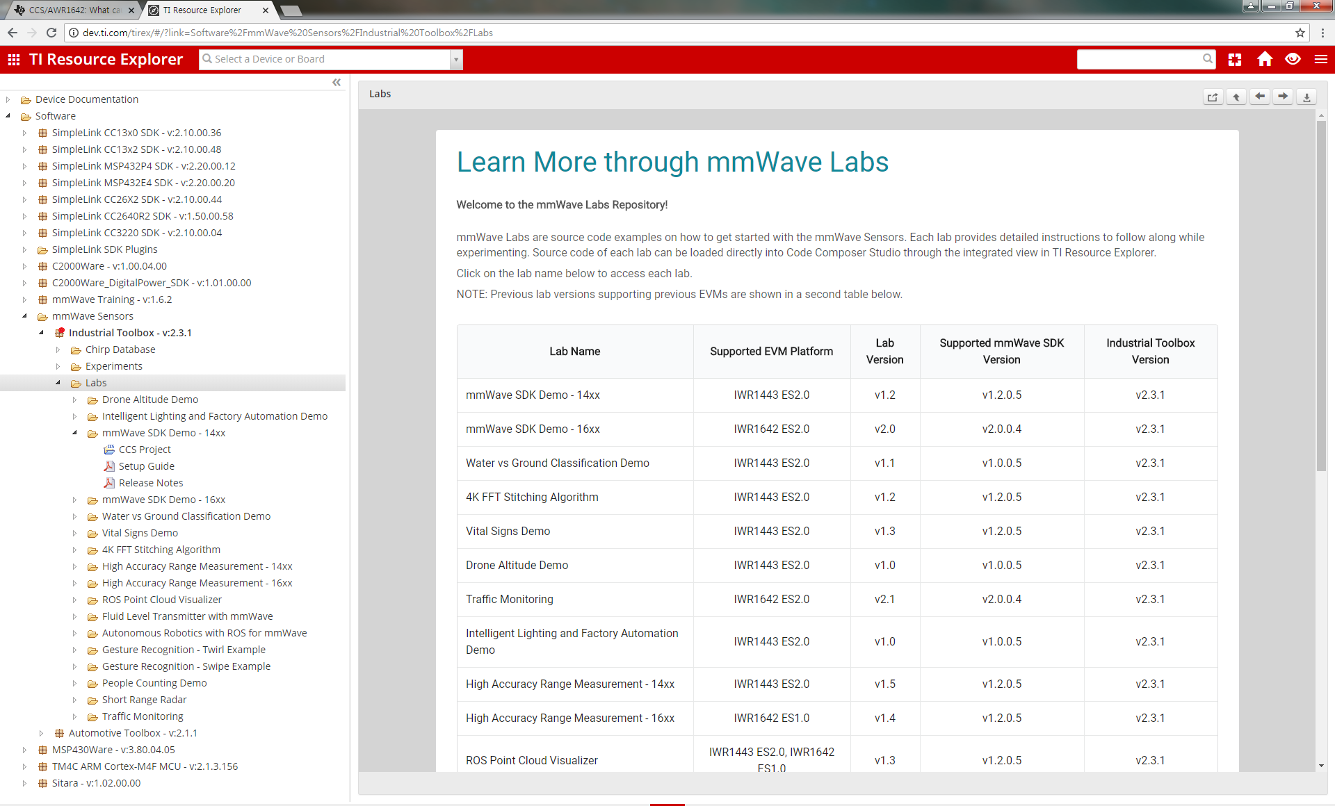

  • The CCS projects provided in the mmWave Industrial toolbox in TIRex will solve this problem.  In TIRex, navigate to mmWave Sensors -> Industrial Toolbox v2.4 -> Labs -> mmWave SDK Demo 16xx.  Install and build this (both MSS and DSS projects), then add in whatever changes you have, if any.
      -dave
  • Hi
    I can not find Industrial Toolbox v2.4.
    Can you tell me the path?
  • 2.3.1 will work fine.  Just download and install the mmWave SDK Demo - 16xx.
