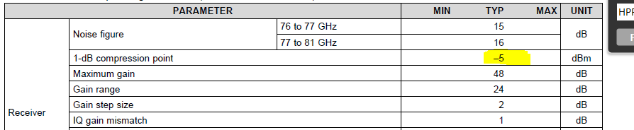

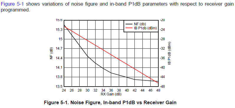

2. Receiver P-1dB spec. 1-dB compression point spec is -5dBm in table, however the in-band P-1dB is less than -20dBm in below figure.
What is the different?

    Q2)The difference for the table,  is that this is at the Rx input before the LNA, and is supposed to be within the Radome reflection frequency which gets filtered with the HPF1, and HPF2 filter.   Figure 5-1 shows the affect on the Receiver with a specific inband signal strength,  the Rx LNA has a range of 24-48db split between 2 stages, along with the 2 HPF filters.    -23dbm  with 24db gain, -35dbm with 36db gain, -47db with 48dbm gain .

    Q2 ) The -5dBm P-1 in table indicate the signal which is reflected in very close distant by radome, unmatched RF circuits or something else, this signal can be filtered by HPF1 and HPF2, right? The P-1 in figure is the in-band signal which will not be filtered by HPF and will be detected?

    Q2) the HPF1, HPF2 should filter out of band signals.  So the -5dbm PQ is filtered by the HPF.  (out of band is  lower frequency than  HPF @ desired attenuation)
    The figure that shows LNA gain. and Noise Figure is for inband signals which are passed (not attenuated)
