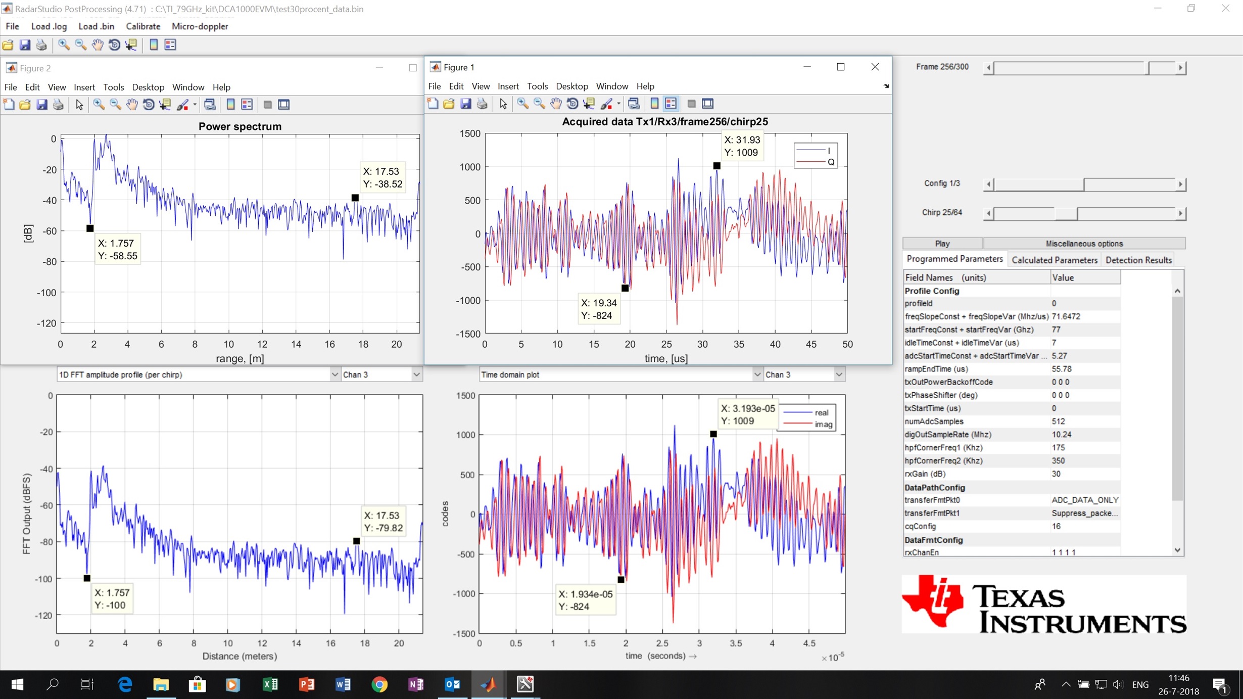

    I have the same issue as you. Actually, I want to process the adc_data.bin file generated from the DCA1000EVM (DCA1000 + AWR1642BOOST). In the documentation, I only found a Matlab code used with TSW1400 but not for raw data generated from DCA1000.
    I am seeing the data analyzed in the PostProc module and also want to do the same (extract signals, frames..... etc ).
    Does the code also works also in my case ?
    thanks in advance,
    Ahmed
    does the code (read_post_process_ADC_Capture_data_LVDS.m) is also available for the AWR1642BOOST ?
    I am using DCA1000 to capture data from AWR1642 (using mmWave Studio).
    I didn't find another way to read the adc_data.bin and do what actually PostProc does.

  • thank you john, I tried it but it seems that the dat and cdat do not have the same shape, I got an error as follows: "nonconformant arguments (op1 is 256x4x128, op2 is 128x4x0)". my configuration is : 4 rx, 2tx, 256 ADC samples, 128 chirps per frame, 8 frames.
    am I missing something ?
    I believe that will be Time Division Multiplexing (TDM) setup. i.e. TX1 transmits and you collect all the chirps from the receivers and then TX2 transmits. At least that is my understanding.
    I suspect the matlab error comes from line 36 where it only has rx and should have rx*tx. For my case it didn't matter as I only had it setup for 1TX.  I've edited the above code in previous post. However, the above code does not take into account TDM. For that you would have to change the indices slightly and reorder the chirps. My advice would be to get the above working for a 1TX and 4 RX scenario. Then modify it.

  • Hi John,
    I tried it with 4Rx and 1 Tx config and it is working but still not sure that I got the same figures as the PostProc ones.
    I think to be sure, I should see the time domain signal and compare it by the postproc generated one.
    the cdat contain the complex data generated (256,4,128), how to proceed to figure out the time domain from it ? I think it is better to format it as follows (as the TSW1600 in the guide does): rows should contains all of the data from the nth receiver ==> 4 rows, nb_columns = nb_ADC_samples * nb_chirps ==> 256*128 , then it is easy to plot the I and Q signal from each receiver, right ?
    thanks in advance,

  • Hi All,
    I am using AWR1642 device with DCA1000EVM to read ADC data.
    the matlab code I am using does not give me the exact results as the matlab PostPRoc does.
    can any one help me ?
    thanks in advance,
    Ahmed

  • Hi Ahmed,
    Please use the matlab script below for processing xWR16xx raw data with DCA1000:
    %%% This script is used to read the binary file produced by the DCA1000
    %%% and Mmwave Studio
    %%% Command to run in Matlab GUI -
    readDCA1000('<ADC capture bin file>') function [retVal] = readDCA1000(fileName)
    %% global variables
    % change based on sensor config
    numADCSamples = 256; % number of ADC samples per chirp
    numADCBits = 16; % number of ADC bits per sample
    numRX = 4; % number of receivers
    numLanes = 2; % do not change. number of lanes is always 2
    isReal = 0; % set to 1 if real only data, 0 if complex data0
    %% read file
    % read .bin file
    fid = fopen(fileName,'r');
    adcData = fread(fid, 'int16');
    % if 12 or 14 bits ADC per sample compensate for sign extension
    if numADCBits ~= 16
    l_max = 2^(numADCBits-1)-1;
    adcData(adcData > l_max) = adcData(adcData > l_max) - 2^numADCBits;
    end
    fclose(fid);
    fileSize = size(adcData, 1);
    % real data reshape, filesize = numADCSamples*numChirps
    if isReal
    numChirps = fileSize/numADCSamples/numRX;
    LVDS = zeros(1, fileSize);
    %create column for each chirp
    LVDS = reshape(adcData, numADCSamples*numRX, numChirps);
    %each row is data from one chirp
    LVDS = LVDS.';
    else
    % for complex data
    % filesize = 2 * numADCSamples*numChirps
    numChirps = fileSize/2/numADCSamples/numRX;
    LVDS = zeros(1, fileSize/2);
    %combine real and imaginary part into complex data
    %read in file: 2I is followed by 2Q
    counter = 1;
    for i=1:4:fileSize-1
    LVDS(1,counter) = adcData(i) + sqrt(-
    1)*adcData(i+2); LVDS(1,counter+1) = adcData(i+1)+sqrt(-
    1)*adcData(i+3); counter = counter + 2;
    end
    % create column for each chirp
    LVDS = reshape(LVDS, numADCSamples*numRX, numChirps);
    LVDS = LVDS.';
    end
    %organize data per RX
    adcData = zeros(numRX,numChirps*numADCSamples);
    for row = 1:numRX
    for i = 1: numChirps
    adcData(row, (i-1)*numADCSamples+1:i*numADCSamples) = LVDS(i, (row-
    1)*numADCSamples+1:row*numADCSamples);
    end
    end
    % return receiver data
    retVal = adcData;
    The function in the previous code snippet will return a matrix with all of the receiver data stored in rows.
    The values for numADCBits and isReal should be modified based on the sensor configuration used. The
    value for numLanes should not be modified as there will always be two LVDS lanes used
    Row 1 contains all of the data from the first receiver, row 2 from the second receiver, row 3 from the third
    receiver, and row 4 from the fourth receiver. In cases where certain receivers are disabled, the
    corresponding rows will be removed. Each row will contain a number of columns equal to the number of
    ADC samples per chirp multiplied by the total number of chirps.
    For
    example, if there are 256 ADC samples and a total of 16 chirps (8 chirps/frame x 2 frames), each row will
    contain 4096 columns. The first 256 columns correspond to the first chirp, the next 256 columns to the
    second chirp, and so on. The first 2048 columns correspond to the chirps of the first frame, and so on.
    The data can then be processed as the user desires.
