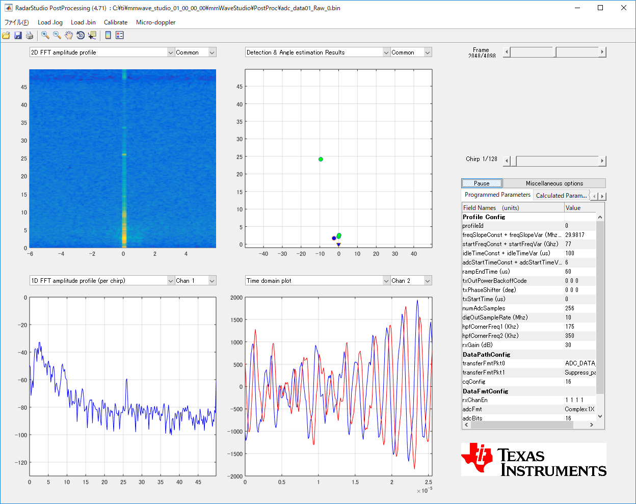

I try to capture many frames data by mmwaveStudio.
At "Sensor Config" tab,I set "No of Frame" 4098,then I named dump file as "adc_data01.bin".
I pushed "DCA1000 ARM" .Next I pushed "Trigger Frame".
Data Capture start,created 3 files.
(adc_data01_Raw_0.bin 1,048,576 kb)
adc_data01_Raw_1.bin 1,048,576 kb
adc_data01_Raw_2.bin 1,025 kb)
Next,I pushed "Post Proc".
Rader Studio once displayed message, "Non-Existant file.Starting the empty GUI now",
But the empty GUI started successfully.
I select Load.bin "adc_data01_Raw_0.bin",pushed "Play".Datas were replayed frame 1 to 2048.
Next,I selected adc_data01_Raw_1.bin,I can not play it.
I pushed "Pause" and play "Play" several times,but I can not play it.
Same as adc_data01_Raw_2.bin.
(I can move frame bar over 2048.But I can not play over 2048.)
Again I select adc_data01_Raw_0.bin,I can play it.
How do play adc_data01_Raw_1.bin and adc_data01_Raw_2.bin?

    Can you send over your output printout so we know your settings and can repeat here?
    Thanks!
    Michelle

  • No need for the binary files. I just want to config the mmwave exactly as you did.
    In mmwave studio, top tool bar select view, then output, you'll see all the printout of the commands executed. Just copy those printout and save in a text file.
    To add attachment on E2E, when replying to this message, you'll see on the bottom right "Insert Code, Attach Files and more....", press that and you'll be able to add attachment.

    Thank you very much.
    I copied the output window.
    I will attach it.
