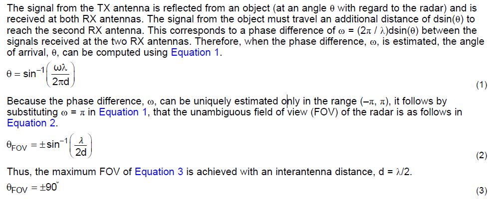

  • Hello Santhana,
    If you go over the MIMO application note which explains the angle and FOV based on antenna design.
    As on the EVM inter-antenna distance is fixed and based on lamda (radar RF frequency, which varies from 76Ghz to 81Ghz) the maximum-FOV would be lesser than 90 degrees. For e.g if lambda is 3.95 mm (corresponding to 76 Ghz), and d is 3.8mm (as on EVM), then the maximum FoV @ 76 Ghz is 74 degrees. Any target beyond this angle will wrap around and appear at -74 degrees.
    Also, the variance of \phi depends on the SNR of the target. If the target has high SNR (for e.g. when the object is closer), the estimate of  \phi will be stable to a larger \phi than if the target has low SNR. Could you try the same experiment with a larger corner reflector? We've noted that errors in estimation increase at these extreme angles.

    I have reviewed the thread information and I would like to mention that for the AWR1642BOOST EVM the horizontal 6-dB-beamwidth is approximately +/- 50degrees (6-dB drop in the gain as compared to bore sight).
    So, we have not validated the behavior at angles 60-90degrees.
    It is possible that the behavior noticed is due to the wrapping around. For 60-90 angles the behavior is indeterminate.
    Thank you
    Cesar
    From the antenna radiation pattern in the horizontal direction, it found that it is not symmetrical. There is about 1db difference between the right and left sides.
    This might be the reason for this behavior.
    Chidvilas
