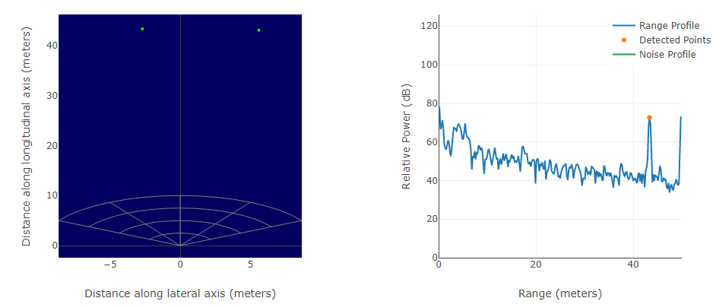

Hello :
        Using AWR1443 to make a circuit board, using a transmit antenna and 4 receive antenna mode, but the transmit antenna and receive antenna are no longer in the same horizontal plane, there is 6 lamda distance. In the process of applying the demo, during the testing of the target, I discovered that I would identify a corner reflector as two targets. The two targets have the same distance from the radar, but their angles are different,As the picture below。I would like to know if the cause of the problem is the 1443 demo program or the antenna arrangement.
