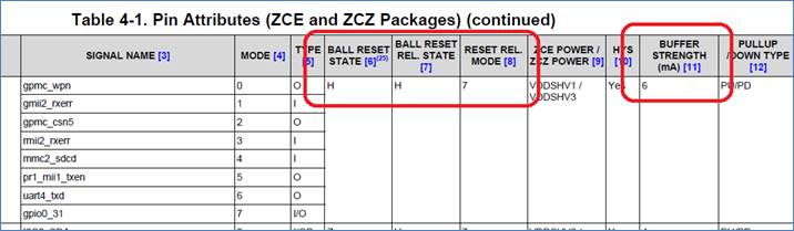

Do you have the following data ?
- GPIO Drive strength
- RESET STATE.
Example

Hi Will,
Only partial answer for you so far. The GPIO controller will be set the GPIO pins into a high-impedance mode after reset. They will stay in this mode until programmed as an input or output.
I am still working on getting the GPIO drive strength for you.
