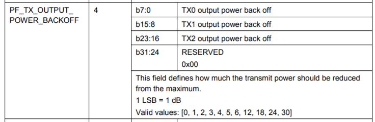

Yes, you could configure Tx power in terms of back-off as shown in the table below.
You could configure through AWR_PROFILE_CONF_SET_SB API.
More details on API and control you could find from the below Radar interface control document.
