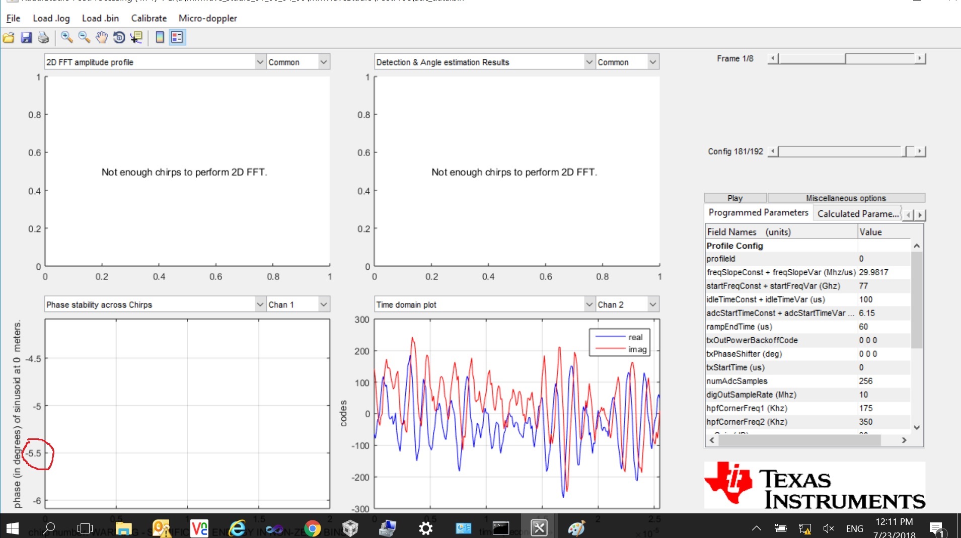

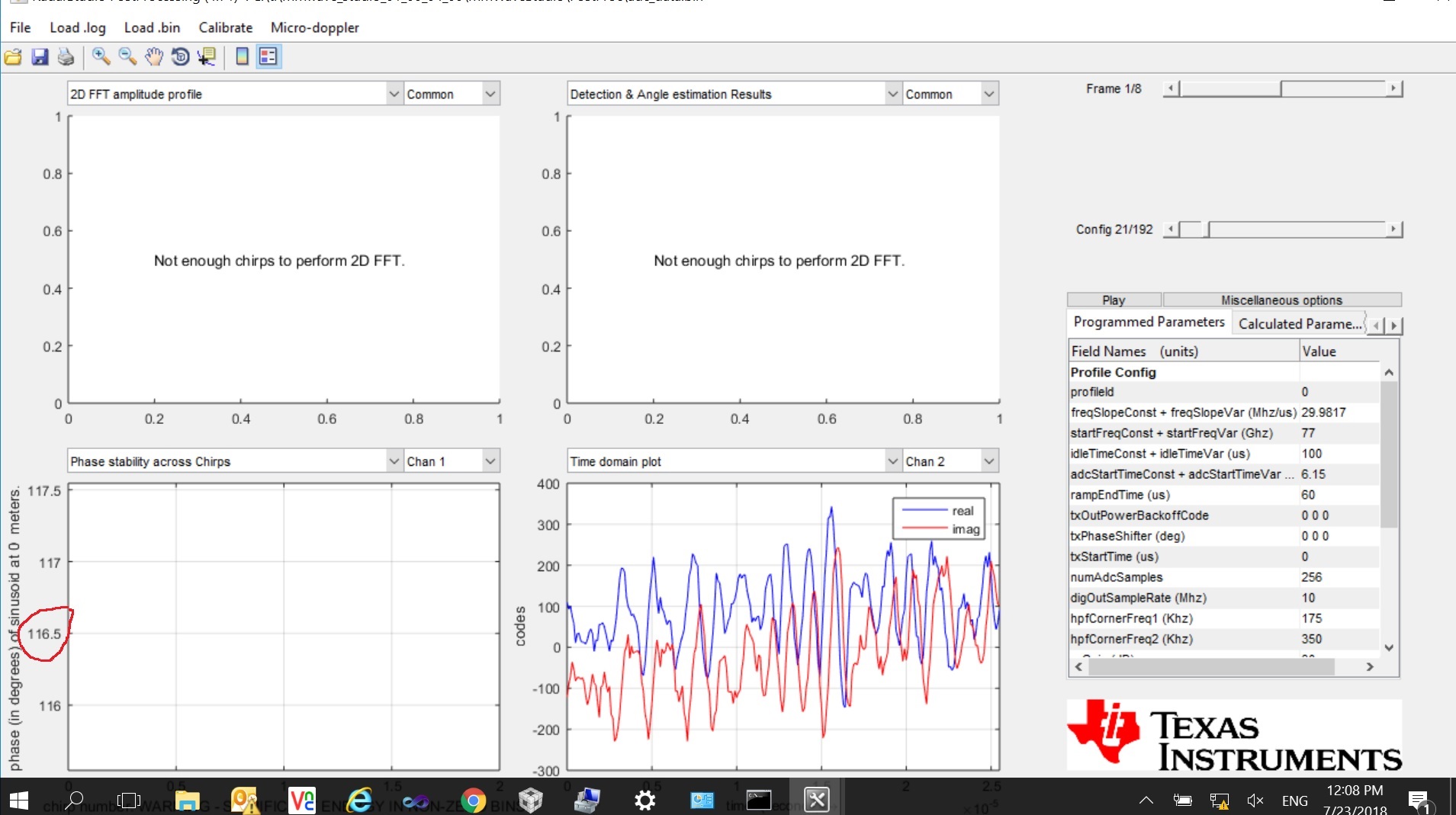

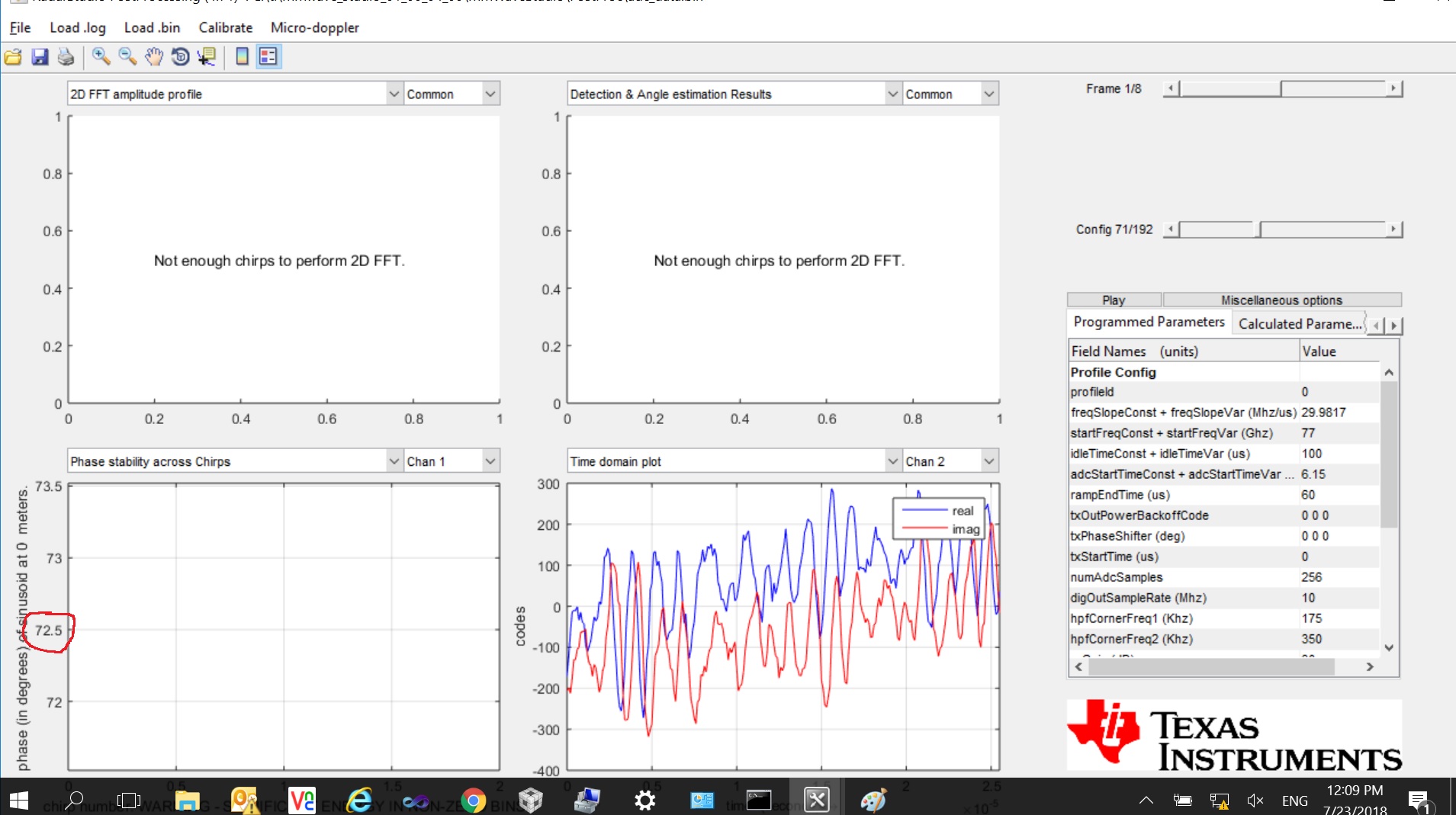

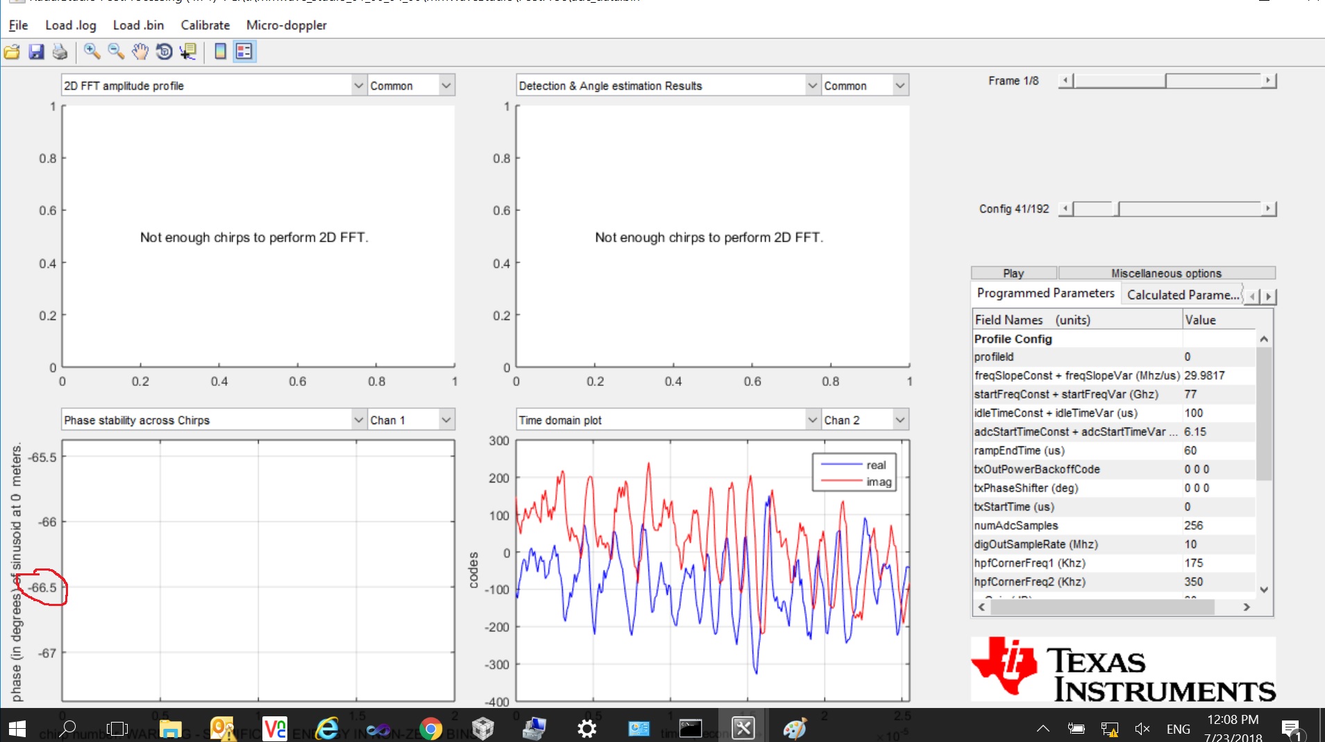

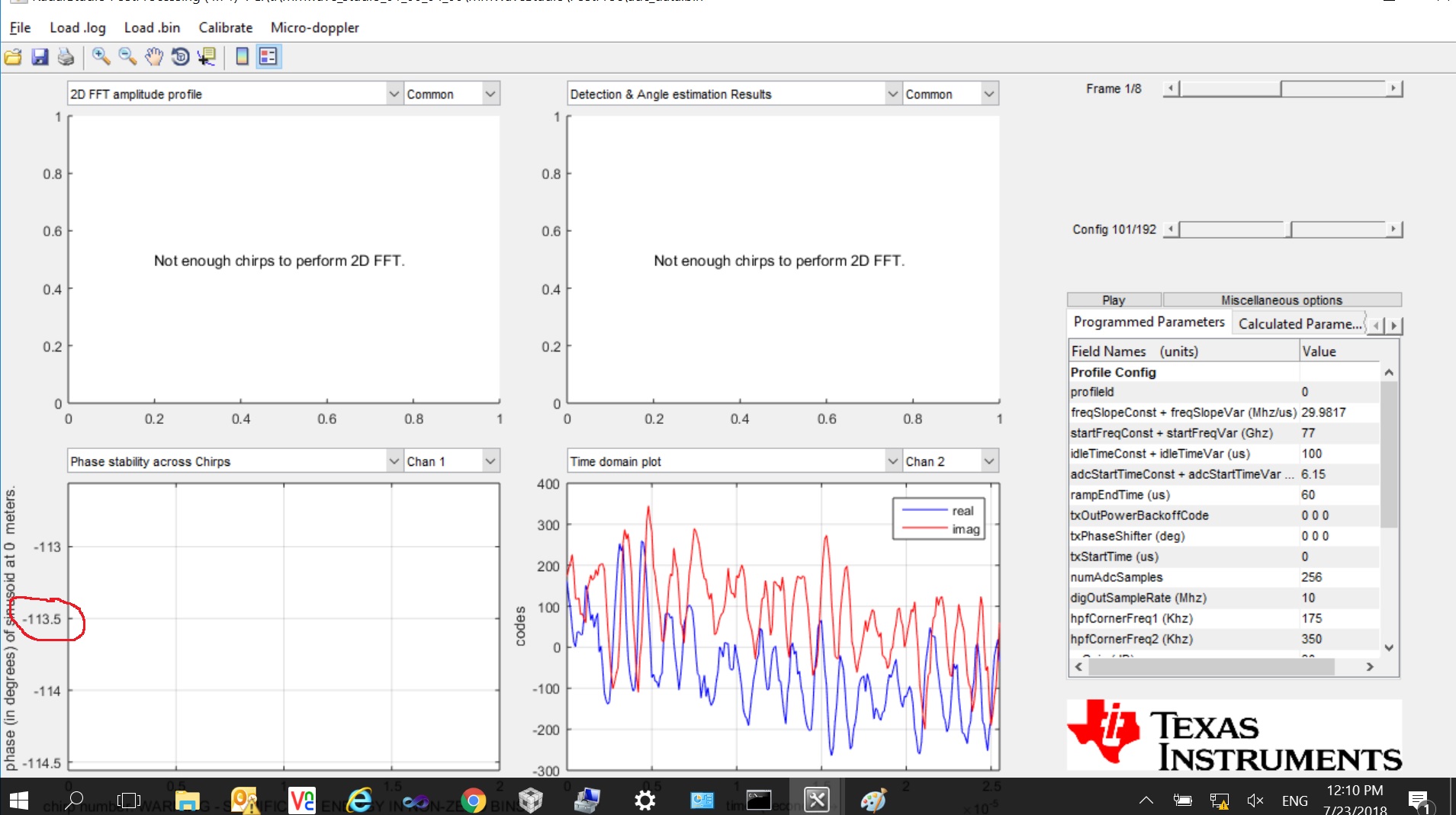

    The 0 deg phase on TX0 seems to be different from the 0 deg phase on TX1 and/or TX2.
    For example, in the case that you have provided, TX0 is at 116 (0deg) and -66 (180deg) where as for TX1, it is 72 and -113 degrees.I can understand, if the 0 deg phase angle values are closer across TX, if not same. But here between Tx0 and Tx1 there is a phase difference  of around 180 deg when bpm are set to 0 in both cases.
    Hopefully you can expliain me what causes this.
  • Santhana,
    You are measuring the phase of Received Signal. Phase of transmit signal is either 0 or 180deg. Now based on the path from TX -> Object - >Rx, there would be additional phase in received signal.
    Since there is antenna spacing between TXs, there would different phase due to slightly different path.
    Also the data I provided is for RX1, If you choose different RXs, you will see again different phases due to spacing between RX antennas.
    Let us know if above answers your question.
