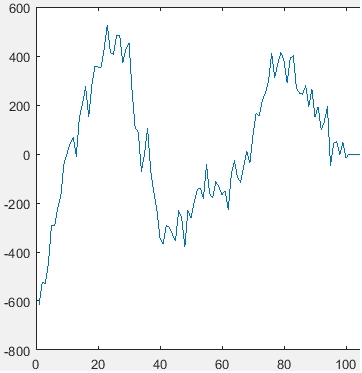

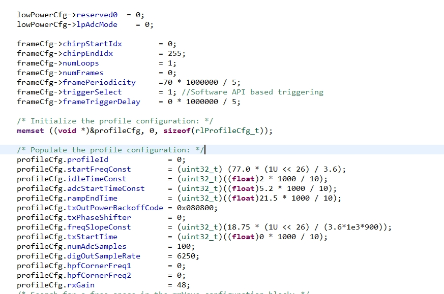

1 Used one object for test to capture and plot the raw data, shown as below the signal is not smooth and there are lots of spur, pls help analysis it and if any unclear feel free to let me know on time.
sweep frequency bandwidth=100MHz, sweep frequency time=16us

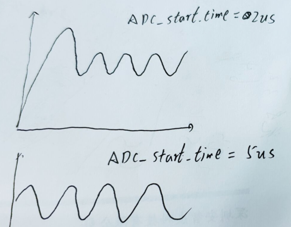

2 The influence of different ADC valid start time on IF signal, shown as below the signal is good when ADCValidStartTime=5us, if configured as 2us then there is impulse at the start of signal. So need your help to analysis and if any unclear feel free to let me know, thanks.
