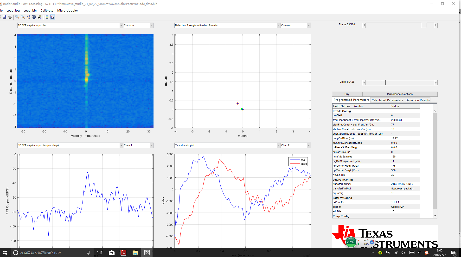

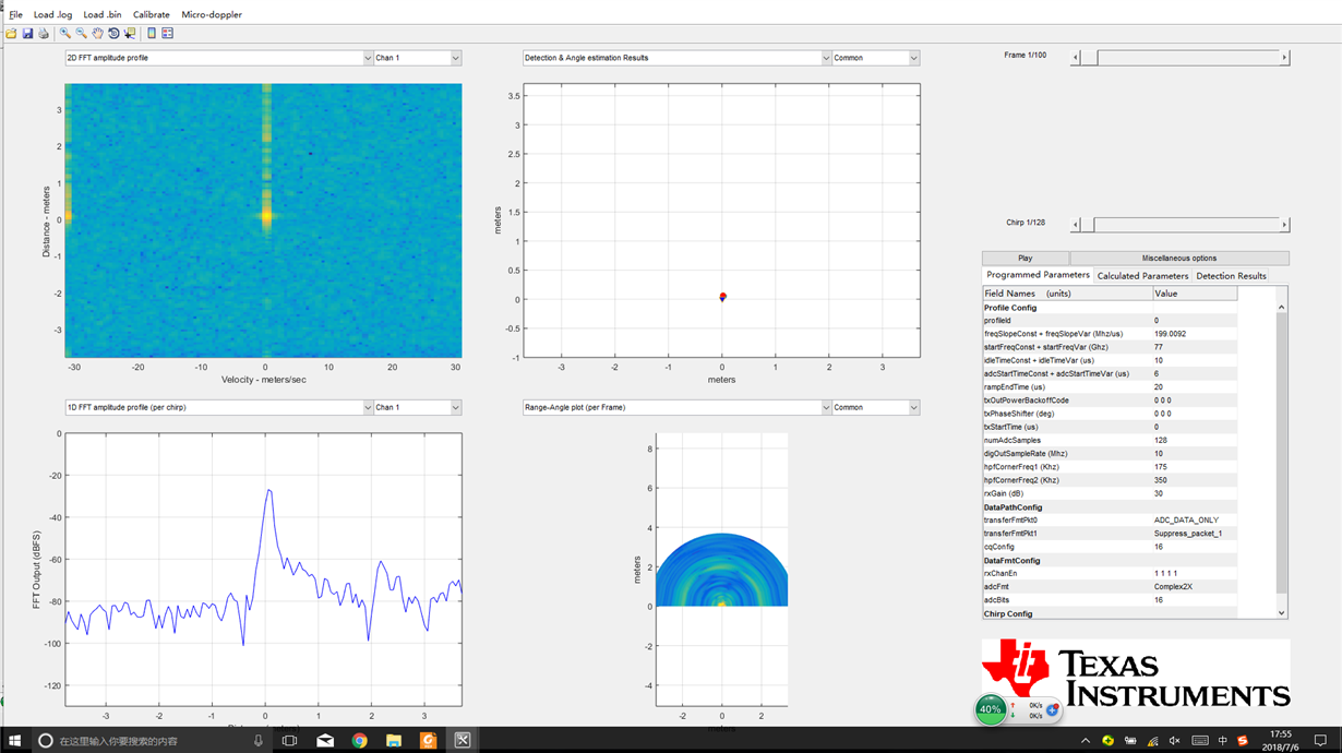

Hi all,
I am trying to capture moving targets within 3 meters,like torso movement, using iwr1642boost + mmwave DevPack+TSW1400.
1.But when i captured data and visulize ADC data via using the Post Processing tool provided by RadarStudio, a very clear signal is always  Observed at 0 Hz. Is this a normal phenomenon?

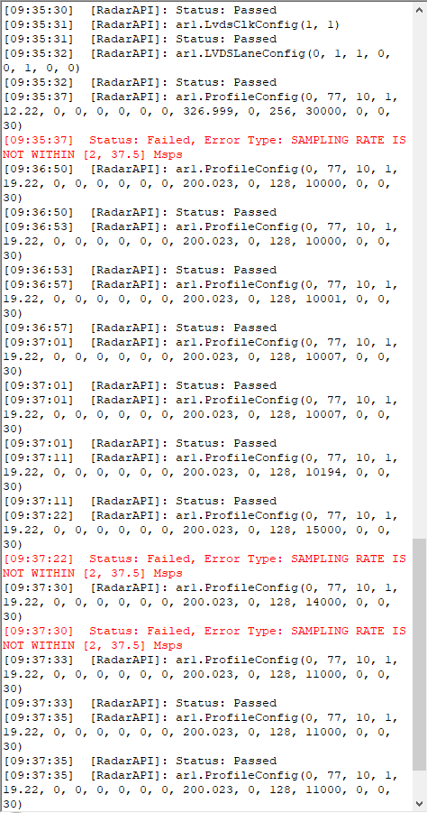

2.when i use RadarStudio to config the profile, I find that value of samples rate cannot be tune up to 15Msps  even i know the range of this value could be cover 2M to 37.5M,how can i fix it up?or something i misunderstanding?

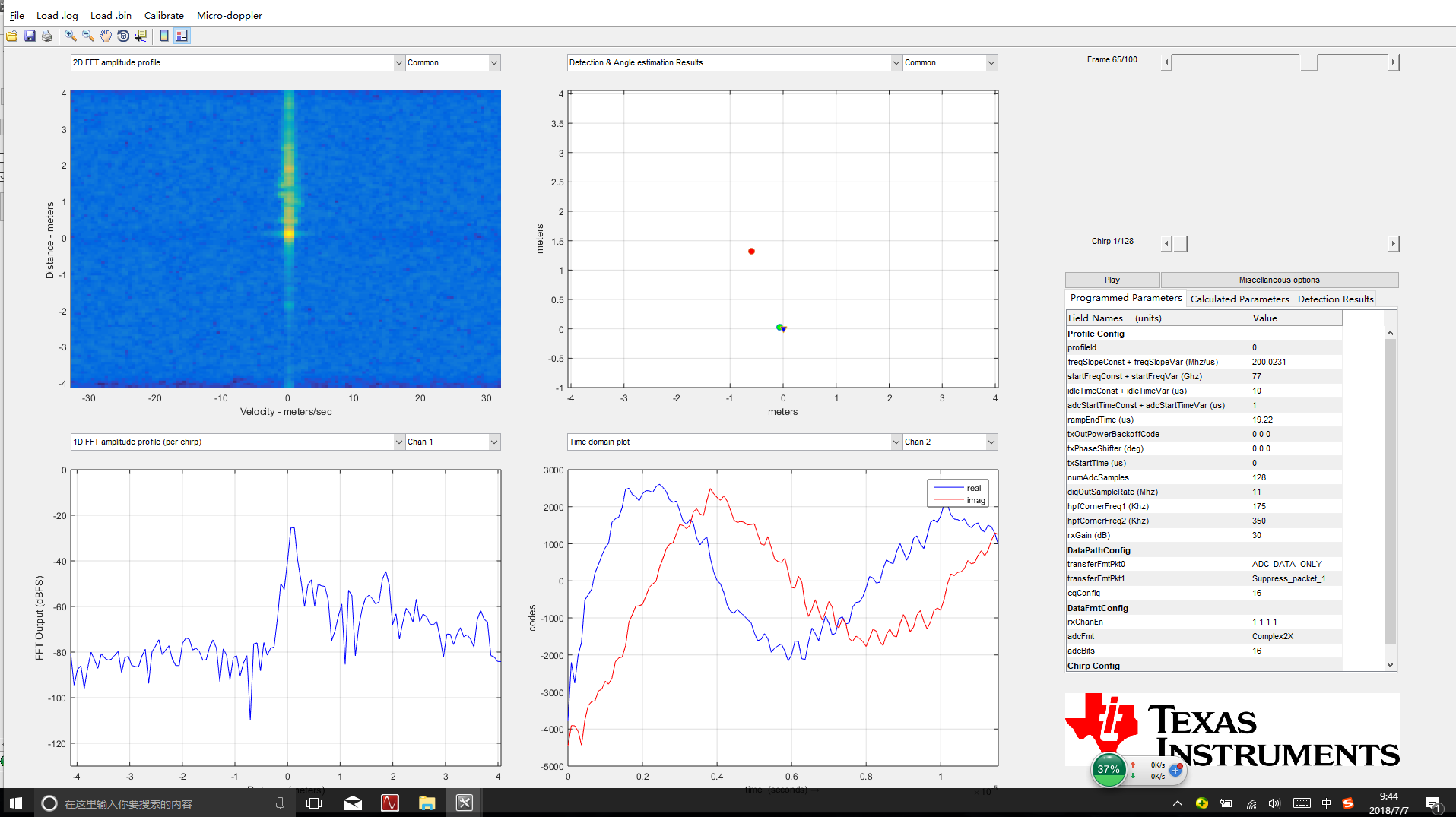

3. I use Post Processing Tool of RadarStudio to process ADC data and plot a   Detection and Angle Estimation results figure. i know target shown as dots in the figure, but what do the dots of different colors mean?
4.For my application scenario, do you guys have any recommended parameters of configuration of RadarStudio?could you share it with me?

    1) The DC component can be self-excited internal to the mmwave sensor, can be a DC bias internal to the mmwave sensor, or can be based on close reflections
    from the mounting hardware for the EVM.  Given the +/-60 degree azimuth, and +/-20 degree elevation, the mmwave sensor antenna needs to not see any close in reflected objects.
    Under the Post Processing, Misc options, there is a DC removal option.
    2) the IWr1642 has a 5Mhz Complex 1x Bandwidth limit, the IWR1443 has a 15Mhz Complex 1x bandwidth limit.  Please see the datasheet Table that compares the features of the parts.  The 37.5Msps is the real sample rate for an IWr1443.
    3) the Post Processing detection, is the CFAR detected objects.  Depending on the Misc options, the CFAR mode, db SNR, the object being reflected, and the Rx LNA gain under the profile - Sensor Configuration, will change the number of detected objects.
    I have included an example for Radar Studio.
