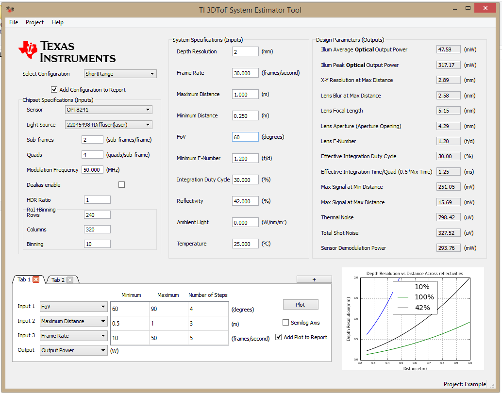

  • Hi Suramya Gupta (4757684)
    Thanks for your clarification and sharing reference doc, I will go through it.
    For quick discussion, Actually I need to have at least 1mm accuracy measure in Depth, For PoC 2 mm will be fine.
    Please check below screen shot I have applied combination, Request your advise on this.
    Please note that I have selected Depth resolution: 2mm, Binning: 10 and change FoV
    Thanks & Regards
    Deep
    You cannot change the FoV of the lens present in the EVM. You need to enter the diagonal FoV. Please go through the document.
    Please go through the OPT9221 and OPT8241 datasheets for further details about the parameters.
    Suramya
  • Hi
    I have choose FoV as per EVM (instead of 59.xx, used 60 for vertical side).
    please guide if I follow wrong way.
    Deep
  • As I said previously, you have to use the diagonal FoV. Please use the default values if you want to check performance of OPT8241-CDK-EVM.
    Suramya
