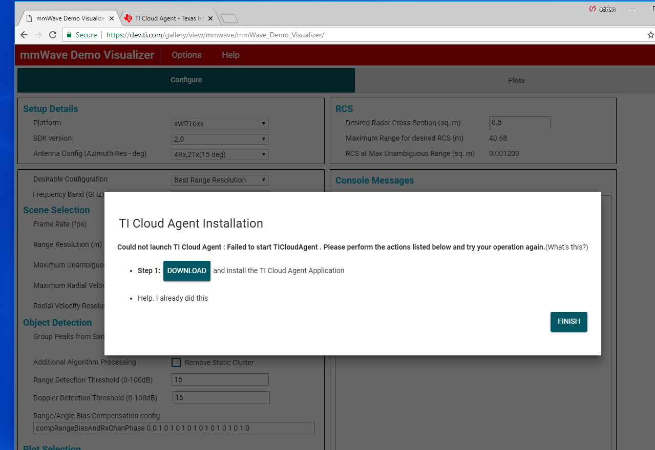

AWR1642BOOST: mmwaveDemovisualizer ti_cloudagent does not work in user mode in Windows
Part Number: AWR1642BOOST
I have tried to get the out of the box demo working in user mode. I have installed the plugin. I downloaded the ti_cloud agent_2 and installed it in various directories c:\users\<user name>, c:\ti or c:\Users\administrator
It always goes back to TI Clod Agent Installation message as in the the attached screen shot. It does work when I am logged in as Administrator but I would prefer to work as a normal user. A log file is not created.
It does work when I am logged in as administrator.

  • Kyle,
    Just to emphasize that It all works when I am logged in as administrator. Here is the screen dump. I keep doing it and it comes back to the same message. I have enabled the log file in c:\temp but a log file is not created.

  • Please don't close the thread. For security policy reasons I can not run in administrator mode on the system. We need to get to the bottom of this please.

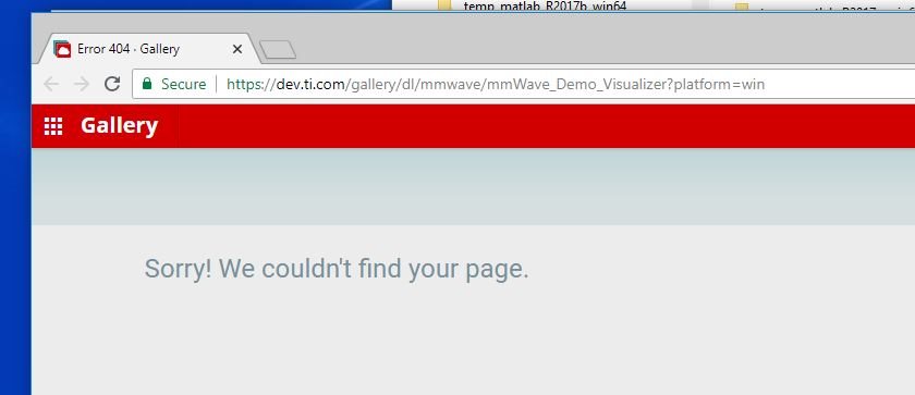

  • Kylie,
    1. I have downloaded and installed the composer runtime. One question here is why it the recommended install path in the user's home directory rather than some common directory for all users? Same with the ti agent.
    2. When I tried to download and install the demo visualizer app I get an error message that the page can not be found. Can it only be visible from inside TI and not available to the outside world? I will insert a screen dump in message. Where can I find the code for the PC client application?
    Also tried to browse myself and could not find a download for a stand alone client app.
    Adrian
  • Adrian,
    The download links have been updated. Here are the new links:
    The GUI Composer runtime which can be found here:
    software-dl.ti.com/.../gcruntime-6.1.0-windows-installer.exe
    The demo visualizer application here:
    dev.ti.com/.../2.0.0
    The installation directory for both can be specified at your own discretion. Please make sure you use Internet Explorer or Firefox when trying to open these links. The downloads will not work in Google Chrome. I can see that you attempted to download the file using Chrome.
