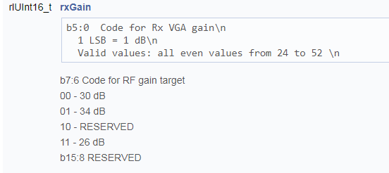

  • Hi Kyle,
    This cfg is used to change the IF amplifer Gain, not the RF LNA Gain.
    We can select RF LNA Gain in radar studio, but how can we change it in OOB demo?
    Thanks.
    Wesley

  • Wesley,
    Here is the information we provide in the documentation for SDK 2.0.0.4 related to the RX Gain. You can see in the documentation that the single field handles both the RX VGA gain and the RF gain target:
    Let me know if you have any additional questions.
    Kyle

  • Wesley,
    This change became effective in SDK version 2.0.0.4. In SDK version 1.2.0.5, the last argument in the profileCfg command only specified the RX gain in dB. Now in SDK version 2.0.0.4, the last argument in profileCfg specifies the OR'ed value of RX gain in dB and RF gain target.
